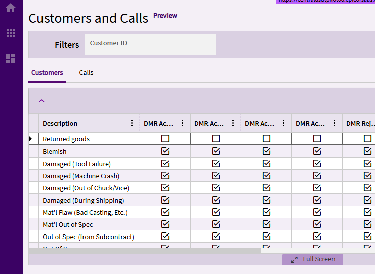

For (3) - Both tabs should have a 1-Panel in it, which has a Panel Card Grid in it:
Customers tab looks good:

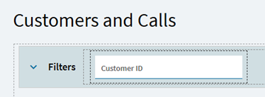

I got this working.
To get around the Text Box disappearing, I had to add a 1-panel to the page and then embed the Text Box inside of the 1-panel element. Putting a Text Box directly in a panel card is not a good idea.
