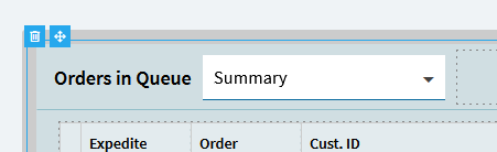

In Kinetic it looks like the tab view is handled by View options as a drop down and thats fine.
My problem is each time i select a new view option it reruns the data pull.

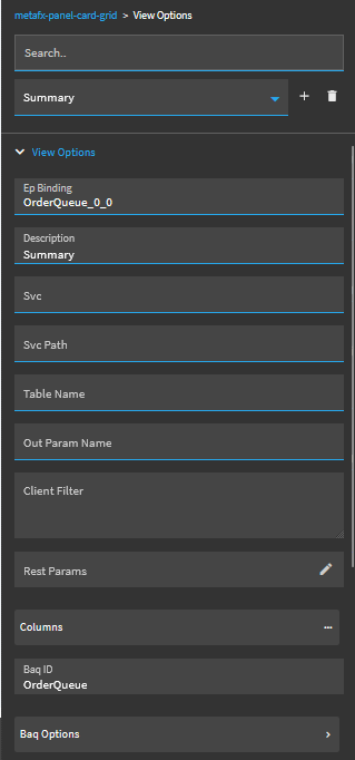

Here is a example of the first view option each of the others are set the same with different Filters.

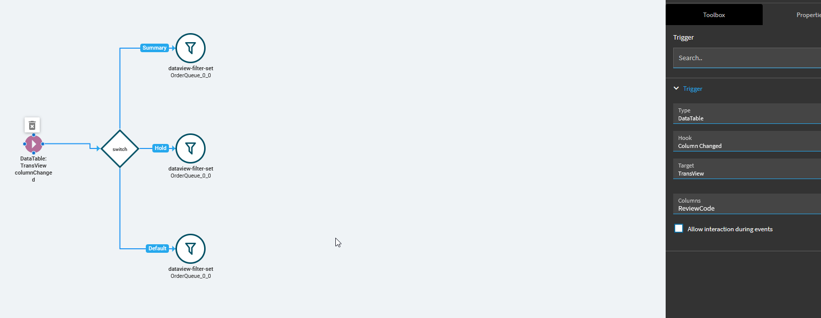

I just played with this because I was curious and it’s not so bad to set up. Not much more work than defining the views, in my opinion and it’s faster.
I might use this going forward. :thinking:
Thanks for the suggestion… though im trying to get the Switch condition to work as i have alot to check.

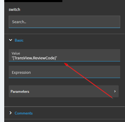

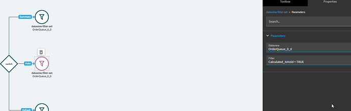

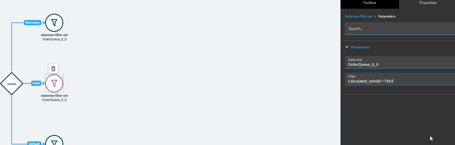

My default setting works as i expect… but the middle one how i would expect it to work is when my transview field = Hold it would fire that condition… and the data does not filter…any one worked with switches before am i missing something?
I can confirm that filter does work if i place it in the default… but none of my other options seem to work on the switch
Try 1 instead of true.
It was me being dump… i forgot to place the value on the switch itself.
