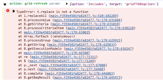

Looks like they added a SQL cleansing function to BAQ Where criteria processing;
This expression now results in an error:
Checking the exception in javascript shows that it’s attempting to do a string.replace() on the resolved value of the right side of the equals sign. This is failing because UD110_Key1 resolves to a numeric: 1, (it’s actually a string on the table, so they should be checking field properties to pass it as a string vs. implicit type declaration…)
There is not a .replace() method on a Number, so it bombs out and does not update the lower grid.

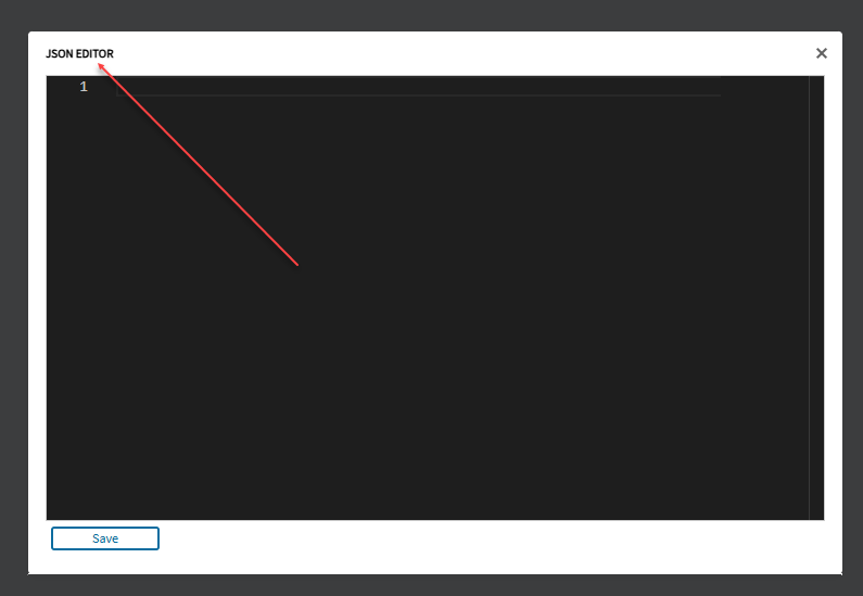

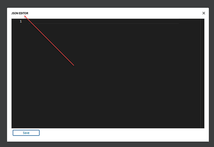

The JSON editors always tell you.
That’s what I mean, it’s the ONLY one in Application Studio to tell you which syntax is expected.
Process of elimination?
JSON Editor tells you.
