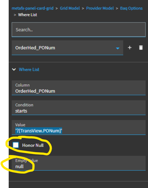

I’m about mid way through our uplift to Kinetic and now comfortable enough to make dashboards from scratch and got the formatting for filters to work.
But one question (so far). what if the filter is blank? I’d like it to show all records.

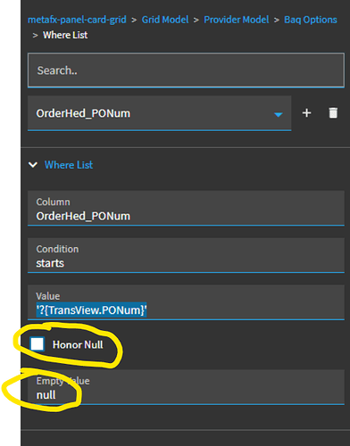

Neither setting Honor Null (on or off) nor Empty Value (null or “”) seem to be doing anything.
The filter works but has to have a value.
Do I have to do something wacky?

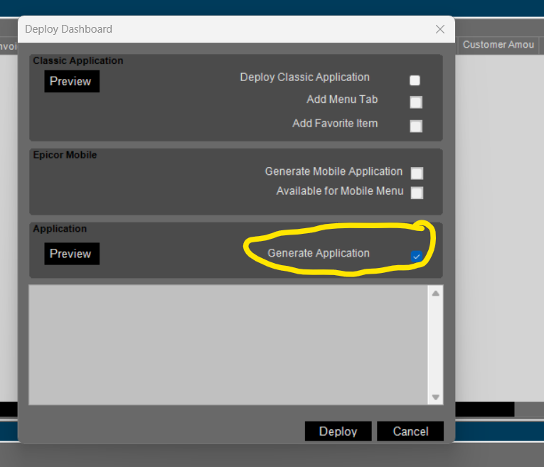

The weird part is that if you make a tracker for a classic dashboard and then select the option to generate a Kinetic application the tracker text boxes allow this behavior. If you leave the tracker field blank all records are selected.
So Kinetic can do it - but how?

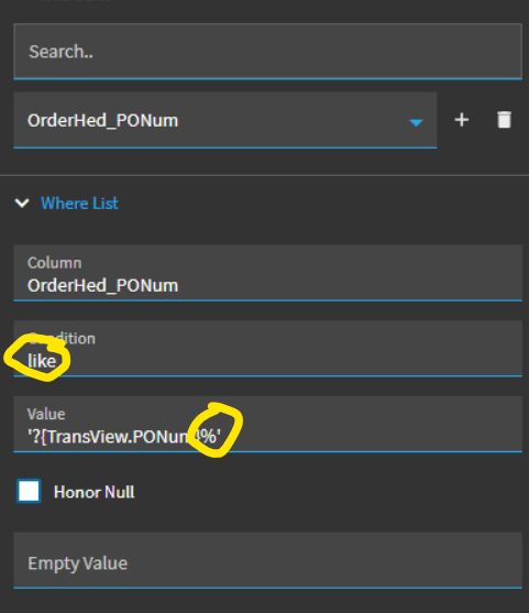

I thought setting the wherelist value to ‘%?{TransView.PONum}%’ would work but that makes it work like a contains clause. Good to know lol but not what I needed.
Try adding a second (?).
I think ‘??{TransView.PONum}’ may pass all values if it doesn’t find a match.
You have my gratitude. That did it!
