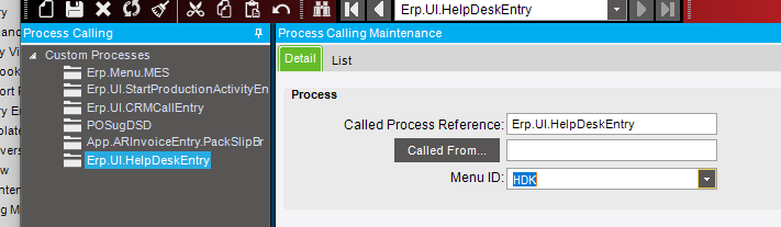

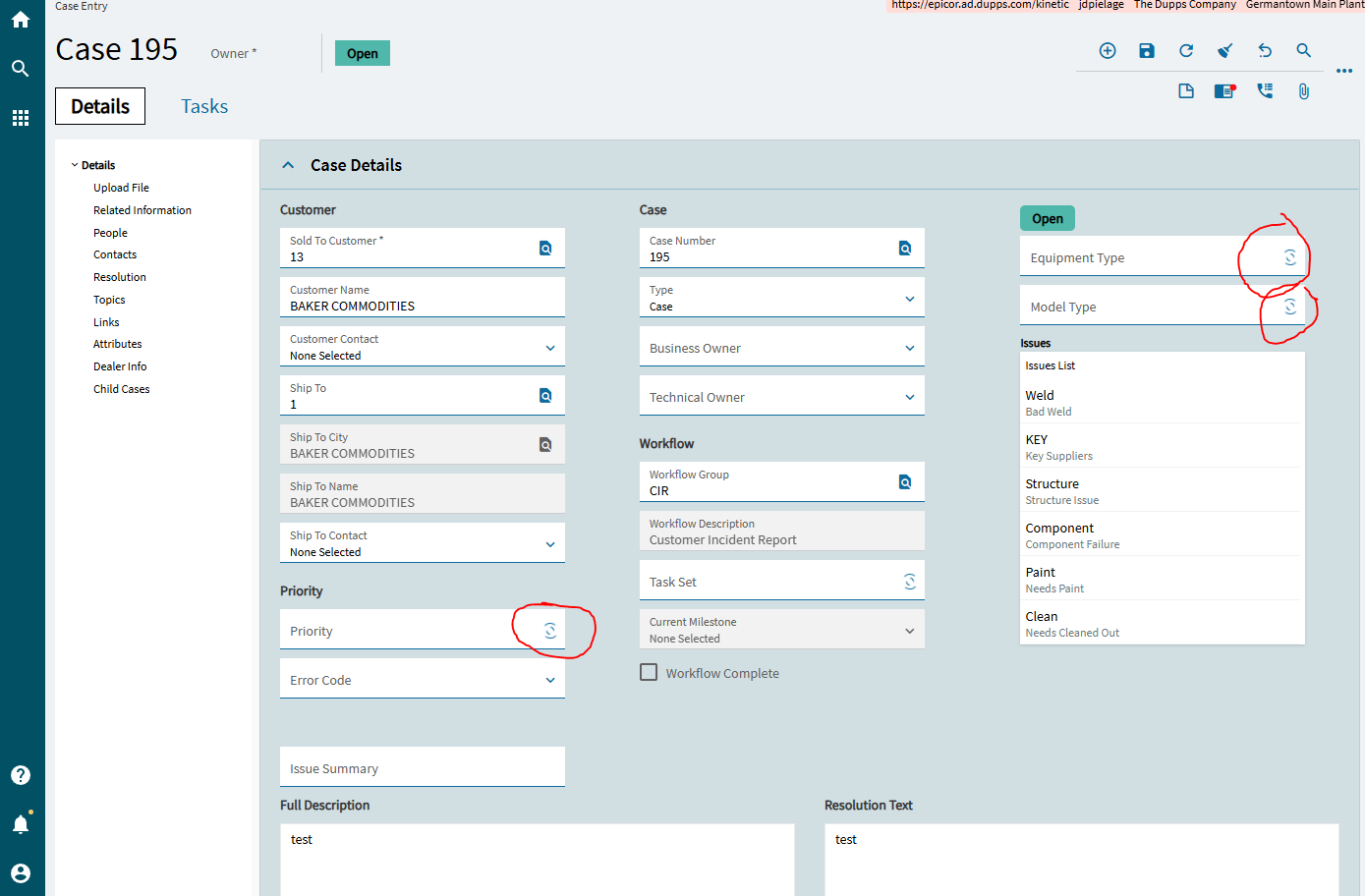

Hello, I’m right clicking Open with Case Entry from a dashboard, and the Case Entry screen doesn’t fully load. There are a bunch of blue loading circles around fields. It seems to be only doing it on custom combo box fields we added to the form. If I manually refresh again it works. I have a Process Calling Maintenance row for opening the form with the correct customization layer. This is an issue on the thick client and the browser. Otherwise, if I open up Case Entry instead of from the dashboard it loads up just fine. Any thoughts are greatly appreciated.

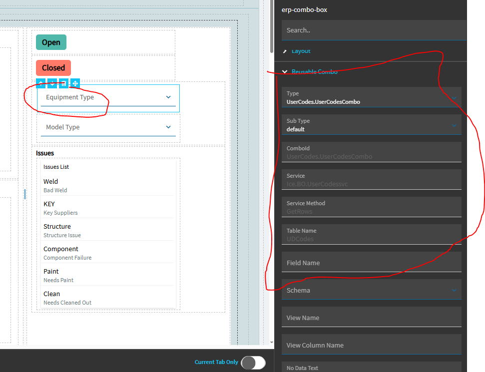

We are not passing any values over to the form when it loads. We just have 3 dropdown combo boxes that pull values form the UserCodes table so users can select options.
I haven’t looked at Kinetic forms yet, but in the Classic forms, whenever we used UserCodes we had to change the EpiDataSetMode from ListDataSet (the default) to RowsDataSet. Maybe something similar is going on here? (I don’t actually know why to use one over the other, just that it worked when we did it)
