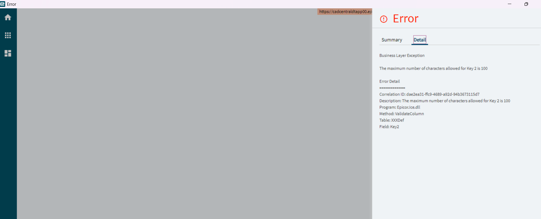

However when I run it from a menu option I get that key 2 is constrained.
It runs fine from application studio.

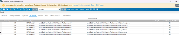

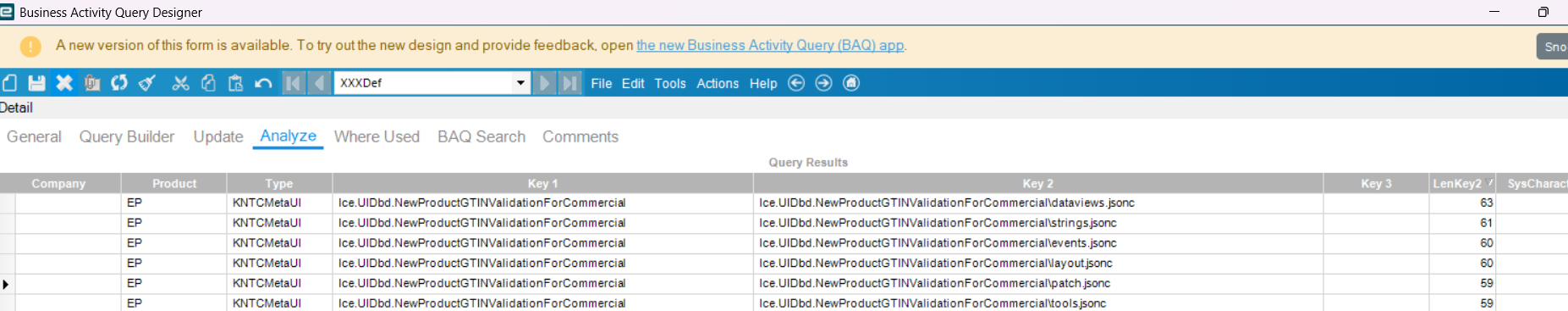

Adding the application name and layer name together is 69
I’d rather not rebuild from scratch. I did save the layer as a shorter name but it created 2 copies with for my company and the other for T_mycompany. So huh?
According to the Purge tool there is no Personalization for this.
Error Detail
Correlation ID: df0d34ca-942d-4c36-91fd-6fd8eb388c78
Description: The maximum number of characters allowed for Key 2 is 100
Program: Epicor.Ice.dll
Method: ValidateColumn
Table: XXXDef
Field: Key2
I’d rename the application if that was possible. Hoping to not have to rebuild from scratch.
