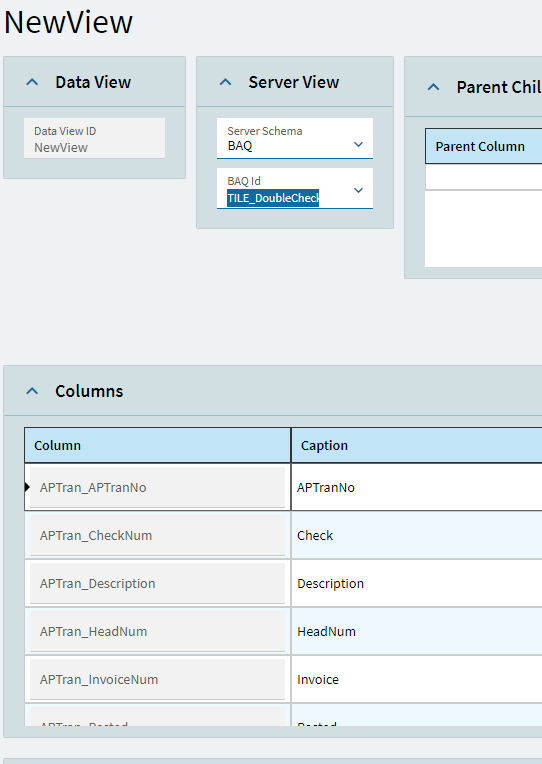

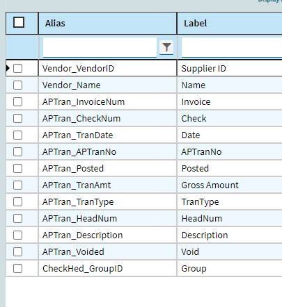

BAQ order (for reference):

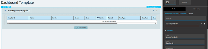

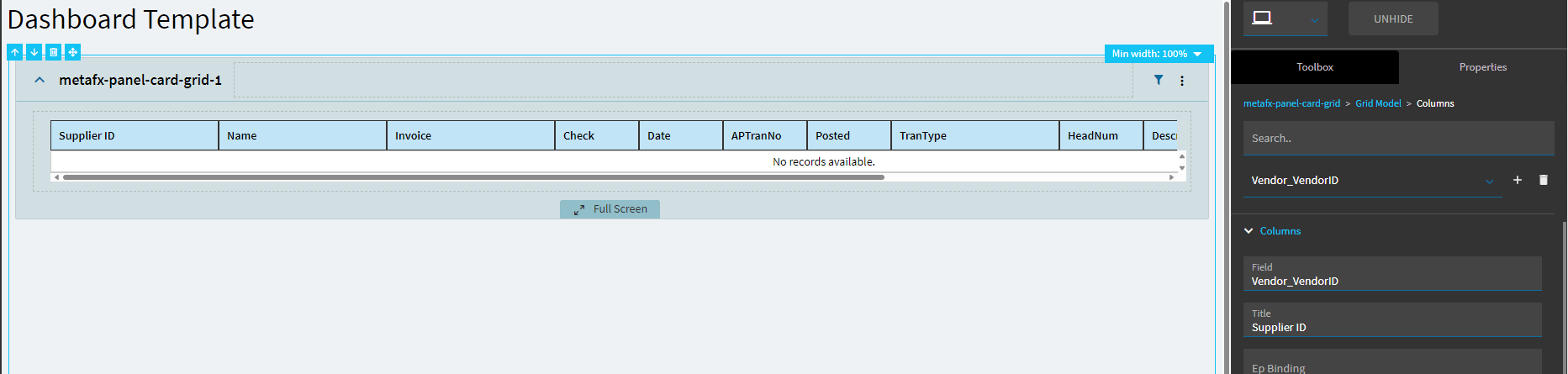

App Studio - had to make the View next (right?). This shows in alpha order:
Then did Guided Setup and behold, the columns are in BAQ order:

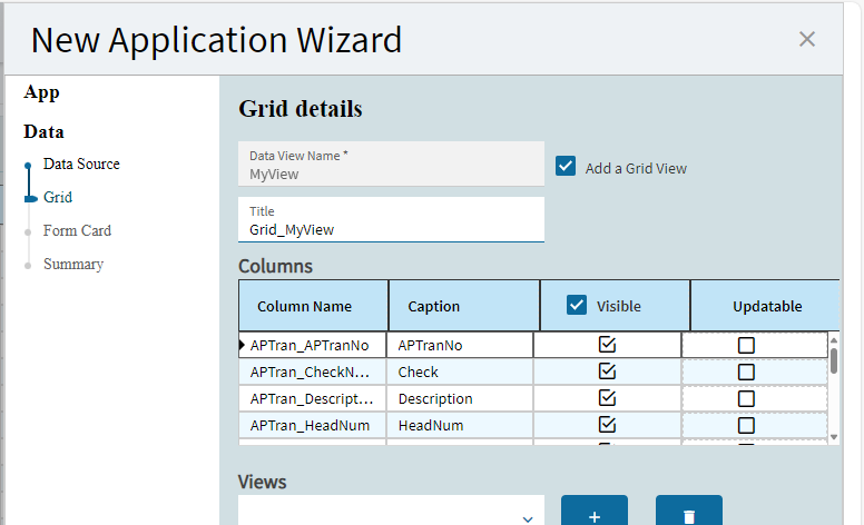

THAT is terrible.

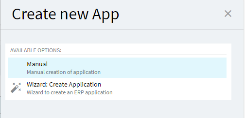

Meaning if you want to fail, in app studio, do this (the wizard):
Then this:

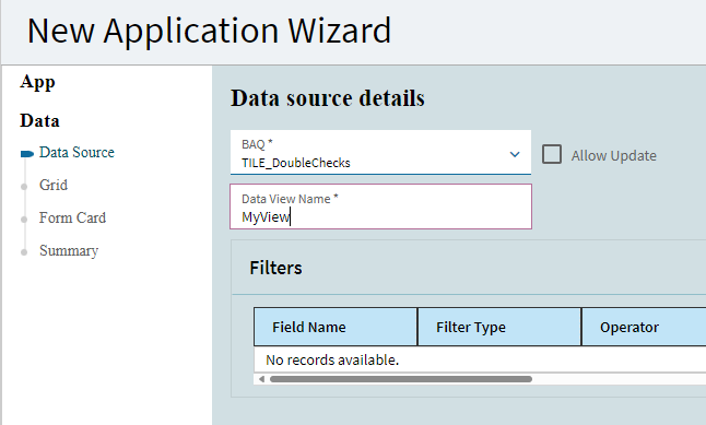

Screenshot 2024-11-07 144232
And next…
(I skipped the Form Card)

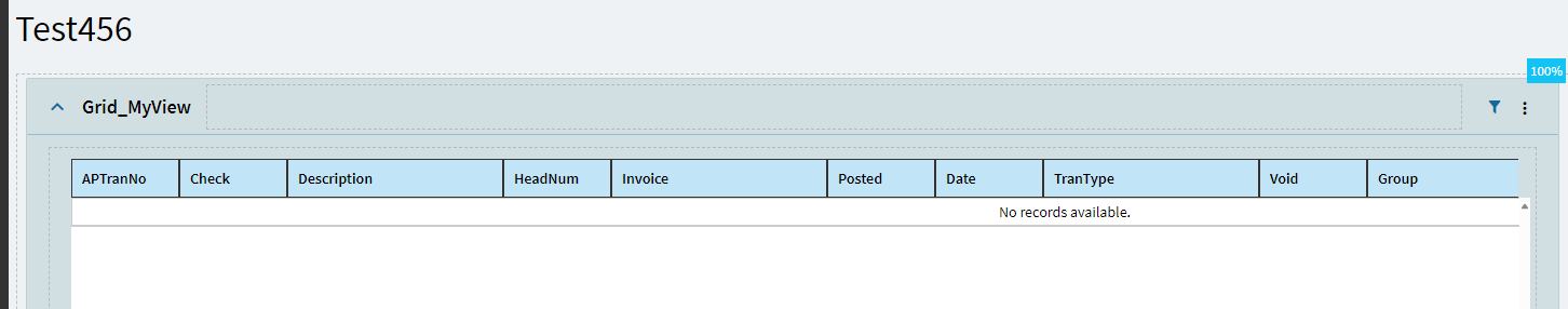

And fail:
But now I understand the one you meant and it does work.

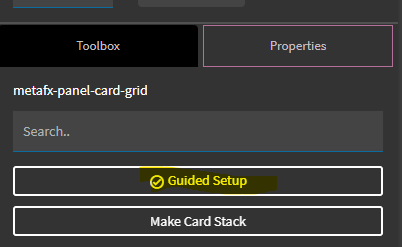

You can do this at any time. You can see in @mbayley’s screenshot, it is at the top of the main page of the properties of your grid in app studio.
