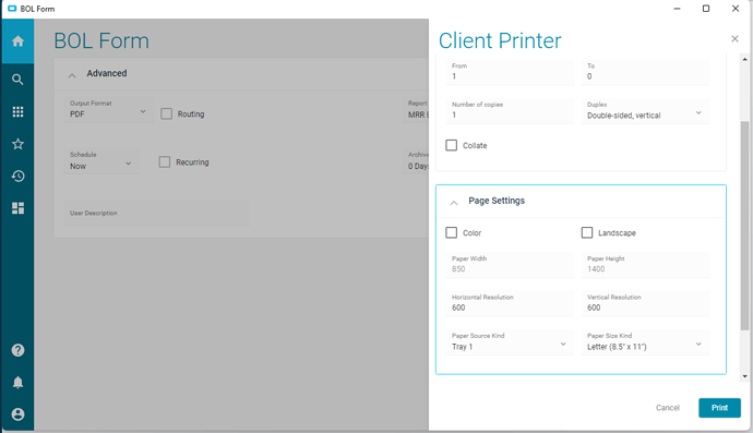

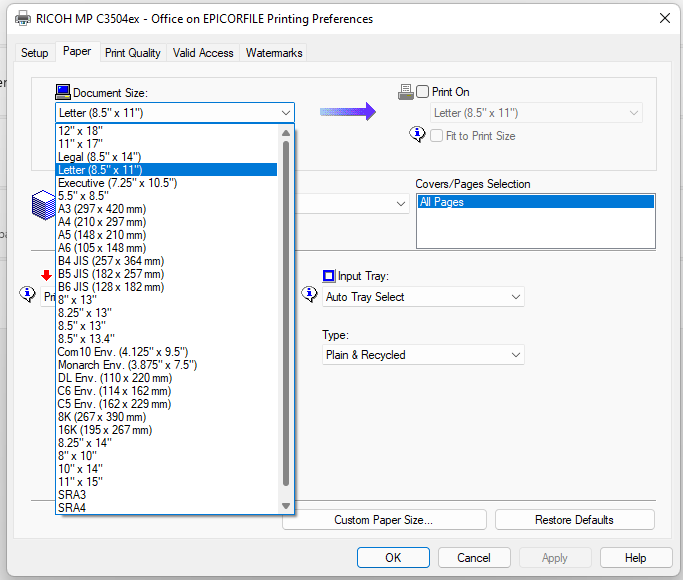

Hello, in Epicor 10.2.600.15 when trying to print with the kinetic form enabled under page settings the Paper Height is not matching the Paper Size Kind and this is causing errors when printing. It changes to the correct Paper Height if I change the Paper Size Kind so it almost seems like it is pulling that initial value from the size of the first item in the Printers Document List as selecting different printers changes what that initial Paper Height value is. Has anyone else experienced this issue and is there a solution for it other than the work around I already established?
