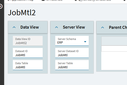

I found a way. I just created a dataview called JobMtl2 like this:`
Then, I created an event that calls the JobMtlSearchSvc.GetRows (Only by JobNum so no AssemblySeq filter) and return the data in that new view
By doing that, everything works and is linked, except the rules. Which means that I’ll just duplicate the rules that I want to apply on that new view

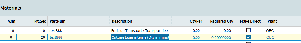

Before update:

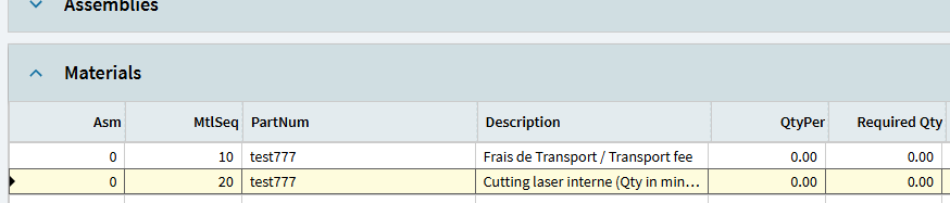

After update on 2nd row:
Both rows have changed the partNum which is wrong
