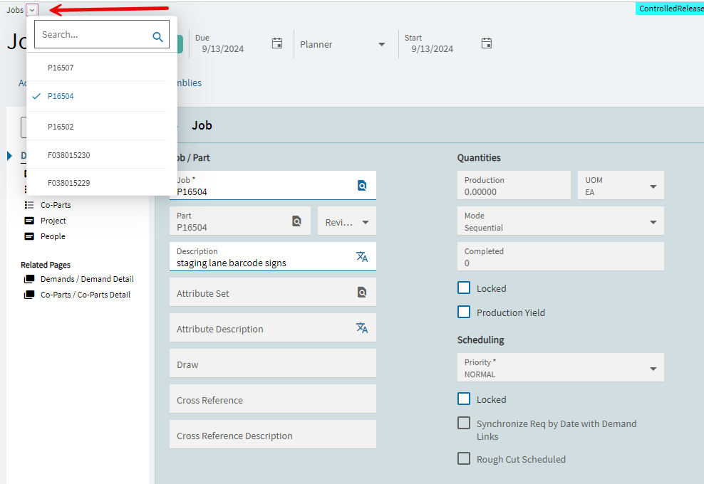

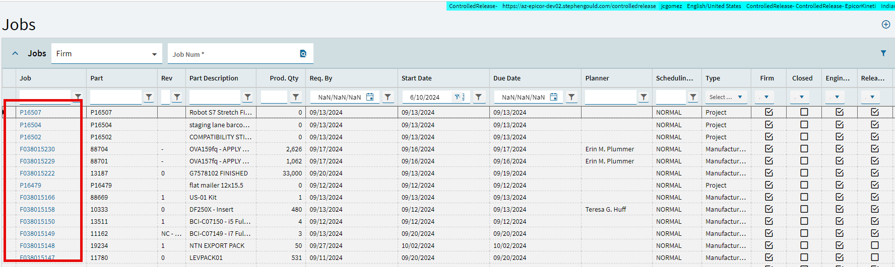

Assuming you can filter what you want in the Job Entry Landing Page
You can then use the record navigator on the top Left of the screen
When the list gets long the “>” drop down I get complaints on from my users. There is also Hot Keys for next and previous.

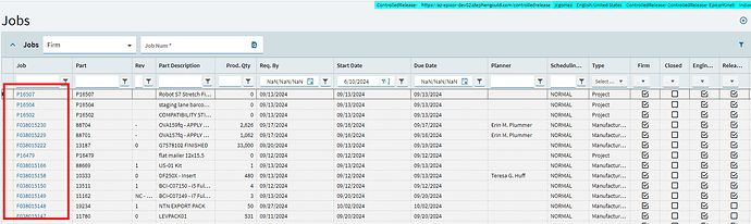

I’m thinking my solution would be to add the “Operation Sequence” type navigator at a higher level for job.
I think if this was in place everyone would be happier.
If a navigator like this was used for all high level screens, jobs, parts, orders, customers, etc. I think would get rid of the feeling of navigating blind.
Would also look and feel a lot like the Classic next / previous navigator.

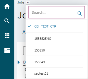

But isn’t the “>” and hot keys basically the same? The classic dropdown is long as well. But Kinetic has a search, so you can reduce the size of the list quickly:
The classic prev, next requires a mouse (IIRC) where the Kinetic is keyboard Ctrl-Left arrow/Ctrl-right arrow- which seems faster to me. :person_shrugging:
Not to be insensitive to your users, but this is mostly about moving :cheese:
