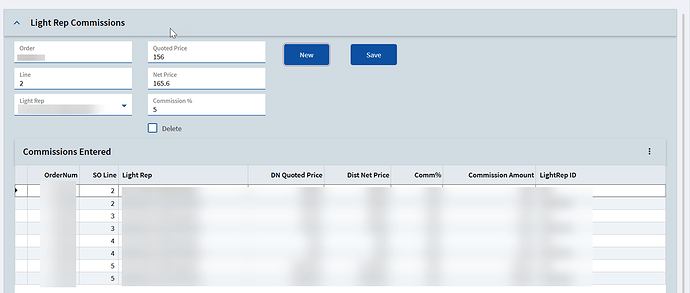

For Kinetic, I did what I should of done for the Classic customization. I converted the uBAQ custom code to a Function, created a non uBAQ as source for a BAQ Data View in App Studio. Created a custom panel card with fields and buttons and a grid to display the data.
