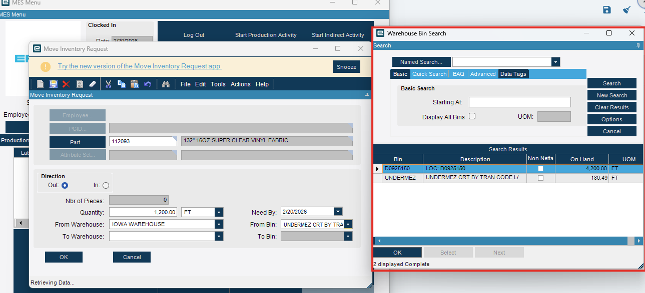

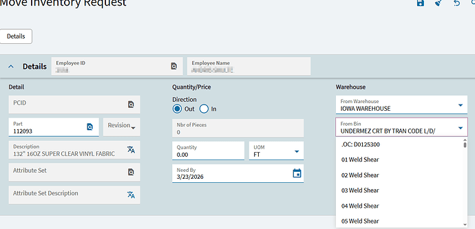

The Kinetic version of Move Inventory Request no longer shows the list of bins with inventory (like Classic does). Kinetic returns every bin (we have thousands!).
How can I filter the dropdown to show active bins only?
I started down the path of doing a BAQ search or a quick search, but wasn’t sure how to pass the partnum parameter. Not sure what’s the most efficient way to get this lost functionality back. I bet it’d speed up the dropdown load too (since it’d return 2 records instead of thousands).

So if you click the dropdown in the From Bin, it only shows bins that have inventory of that part in it (like Classic did)?
I might have to spin up a .14 demo environment and copy how they did it. We’re on .12, and I’m happy (if that’s the case) that functionality has been updated.
I just tested one part but yes, it immediately defaulted to the primary warehouse, and when I clicked the bin drop down it only showed me the bins containing that part. But now you are making me think I should test it with more parts in case its a fluke if you are saying it doesn’t work in .12. It seems unlikely it would have been fixed in a dot release.
