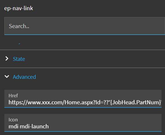

Hello Jose,
here is the Kinetic Nav-Link I am talking aobut.
I want to add querystring in the link to call an external website.
Thanks,
Eddy

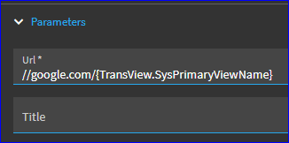

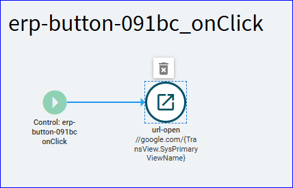

I’ve never played with the Nav-Link before… and couldn’t get it to work referencing a dataview column value (which I’m assuming is what you’re after based on your above screen shot).
But if you add a button, and an on-click event with a url-open component, you just need to put the view.column in curly brackets: { }
Results:
