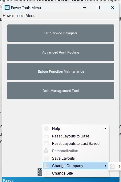

Right-click in the “blank” area below the DMT button and a context menu appears. Select “Change Company”.
By default, Power Tools (as @MLamkin says) keeps the LAST company the userID was logged into.
