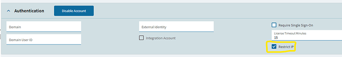

I have come across this check box within User Account Security Maintenance and i cannot figure out what it does so im presuming its related to the next release.

According to the release notes from 2023.1:
"FEATURE:
Set up user accounts so the system validates IP addresses when users log into the system. Do this by selecting the Restrict IP check box on a user account. When a user attempts to log in and the system cannot validate the user’s IP address, the user is denied access.
Review the Adding New Users in User Account Maintenance help article for more information.
BENEFIT
This feature improves security, making sure that all user IP addresses are valid. System administrators control which IP addresses can access the system on a master list (allow-list)."
Unfortunately the help article mentioned says nothing about it, and I cannot find where a System Admin could maintain the master list.

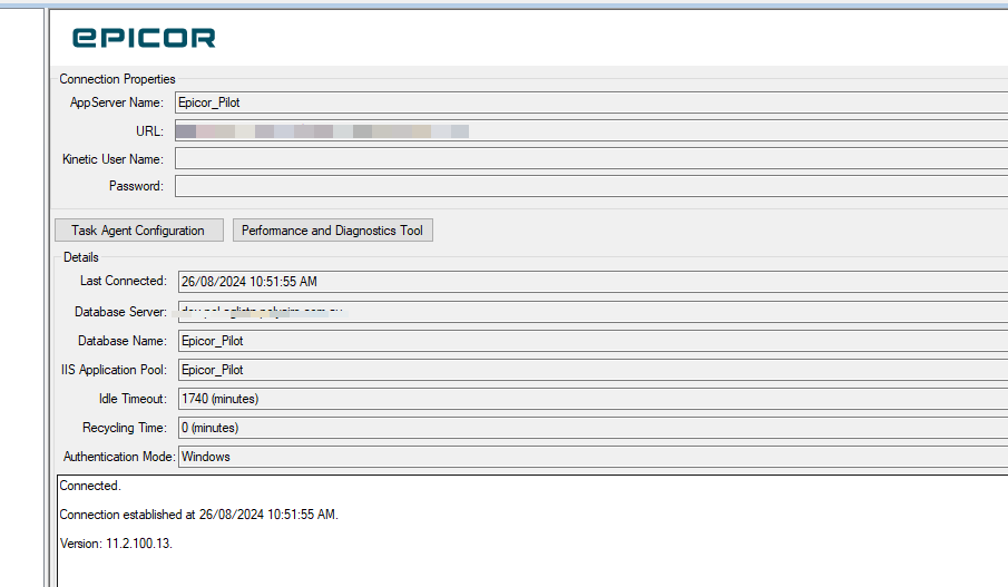

At present, at least for on-premise, there must be a basic authenticated account that is System Manager used for the Epicor Administration Console.
@danvoss Hmmmm we use single sign on… Task agent. Is also SSO, I’ll have to go check this now :confused:
Yes, the EAC can be run remotely, but I’m not sure I would - if for no other reason that it uses Basic Auth.
Task Agents can be Entra ID:
@danvoss
This is how ours is setup.
