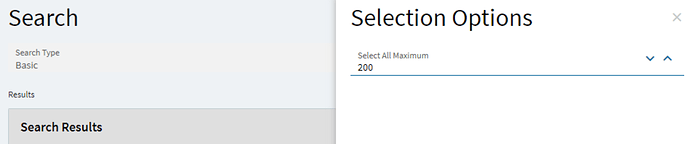

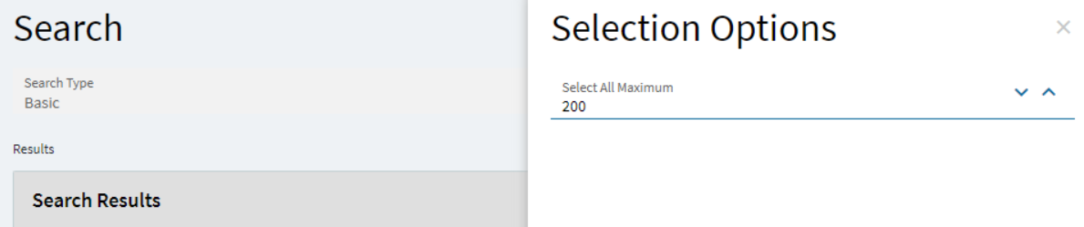

Is there anyway to set the Kinetic Search Selection Option “Select All Maximum”? It defaults at 200 but the user has the option to increase it up to 5000. However, the value selected only applies to that search so the users has to set it each time.

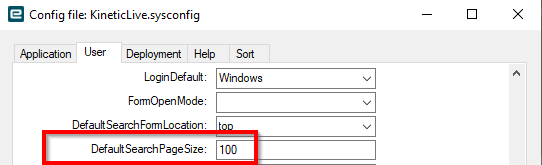

You can set the Default Search Page Size in your sysconfig, You can edit your sysconfig
DefaultSearchPageSize value=“100” /
or use the Config Editor

This controls the number of records returned, not the amount allowed to be selected at one time.
It also does not do anything for the new UX since it will page indefinitely as you scroll.
True, but you can set a high number, I default is ours 1,000 to return a large set instead of the default 200
I do have the DefaultSearchPageSize value=“1000” in my sysconfig but this only applies to Classic menus and doesn’t change the Kinetic Search Select All Maximum

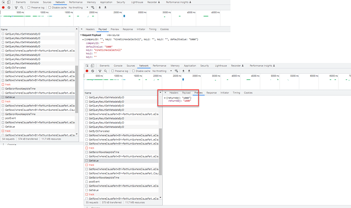

I’m not saying you should do this and if you’re cloud, you’re S.O.L. anyways, buuuuuuut SQL magic:
Use at your own risk; I’m not responsible for your database. Test in a non-production environment. Yadda, yadda, yadda.
This won’t change the visual of the field (it will still show 200), but as you gather enough records past the 200, it will select more. That all being said, the default 200 doesn’t reeaaallly seem to do much. If I remove that row from my DB, leave it at 200, scroll a bunch to load over 200 records, it still selects more. Do with this what you will.
INSERT INTO Ice.SysConfig (Company, Key1, Key2, Key3, SysCharacter01, SysRevID, SysRowID, TenantID, InstanceDefinition, DBHash, InstallationID)
VALUES ('','KineticMaxSelectAll','','','1000',DEFAULT,NEWID(),'','','',CONVERT(uniqueidentifier,'00000000-0000-0000-0000-000000000000'))
SELECT * FROM Ice.SysConfig
WHERE Key1 = 'KineticMaxSelectAll'

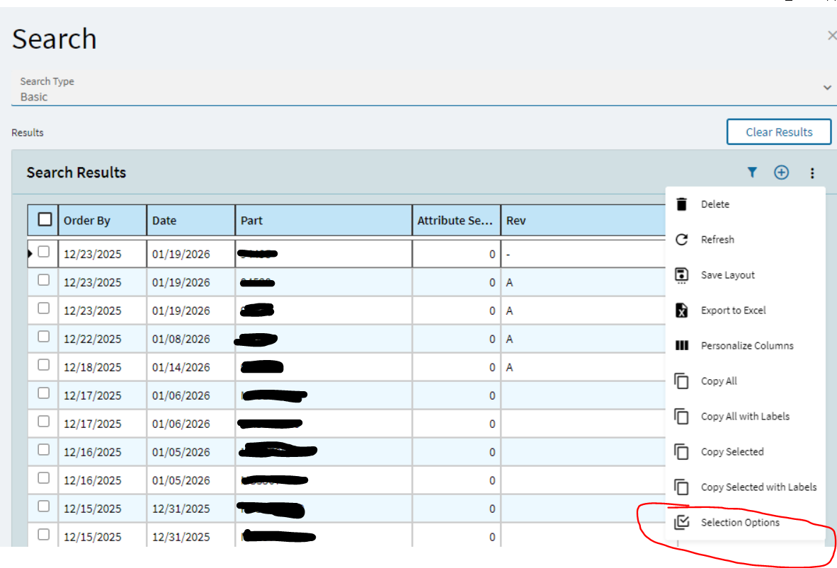

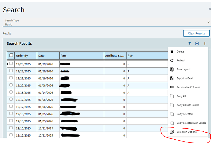

I do see if I leave the selection option at 200 but in the Search Results check the top box to select all…back on the Main Grid if I do a “Copy All” it copies 200. However, if I do an “export to excel” from the main grid I get 173 records. Very quirky :frowning_face:
