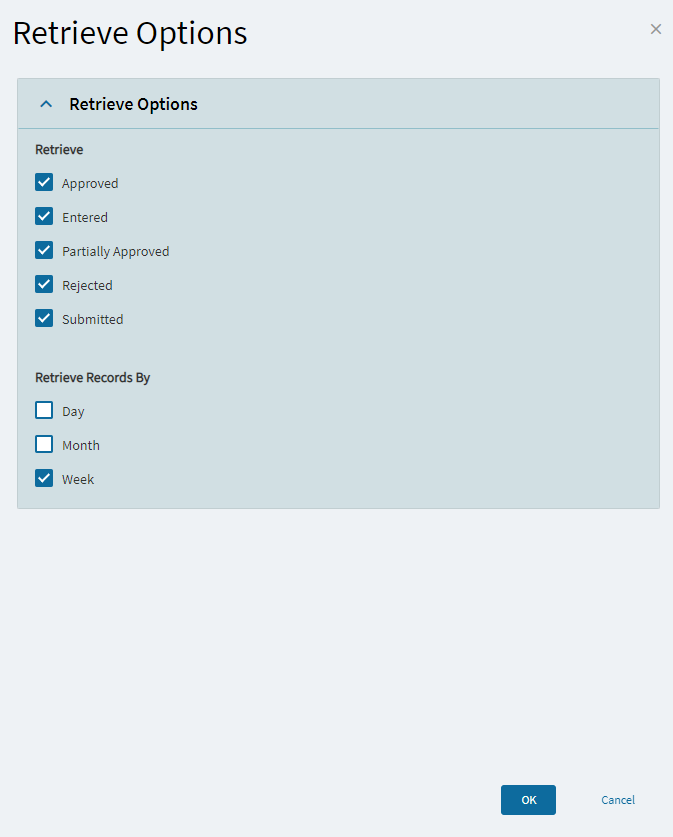

In the classic screen there was an option on the actions menu surrounding how you wanted to retrieve records. The same functionality appears to exist in the Kinetic form.

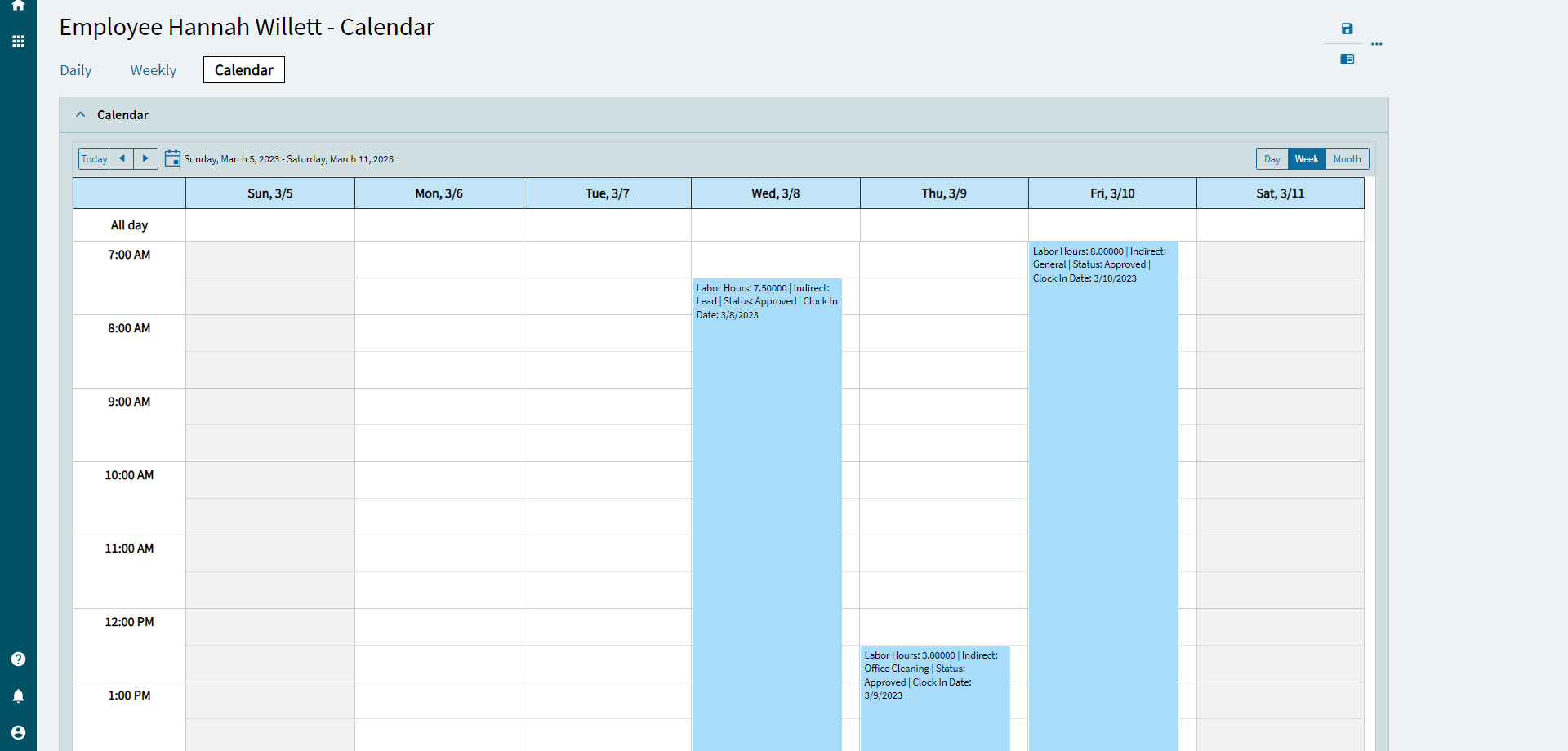

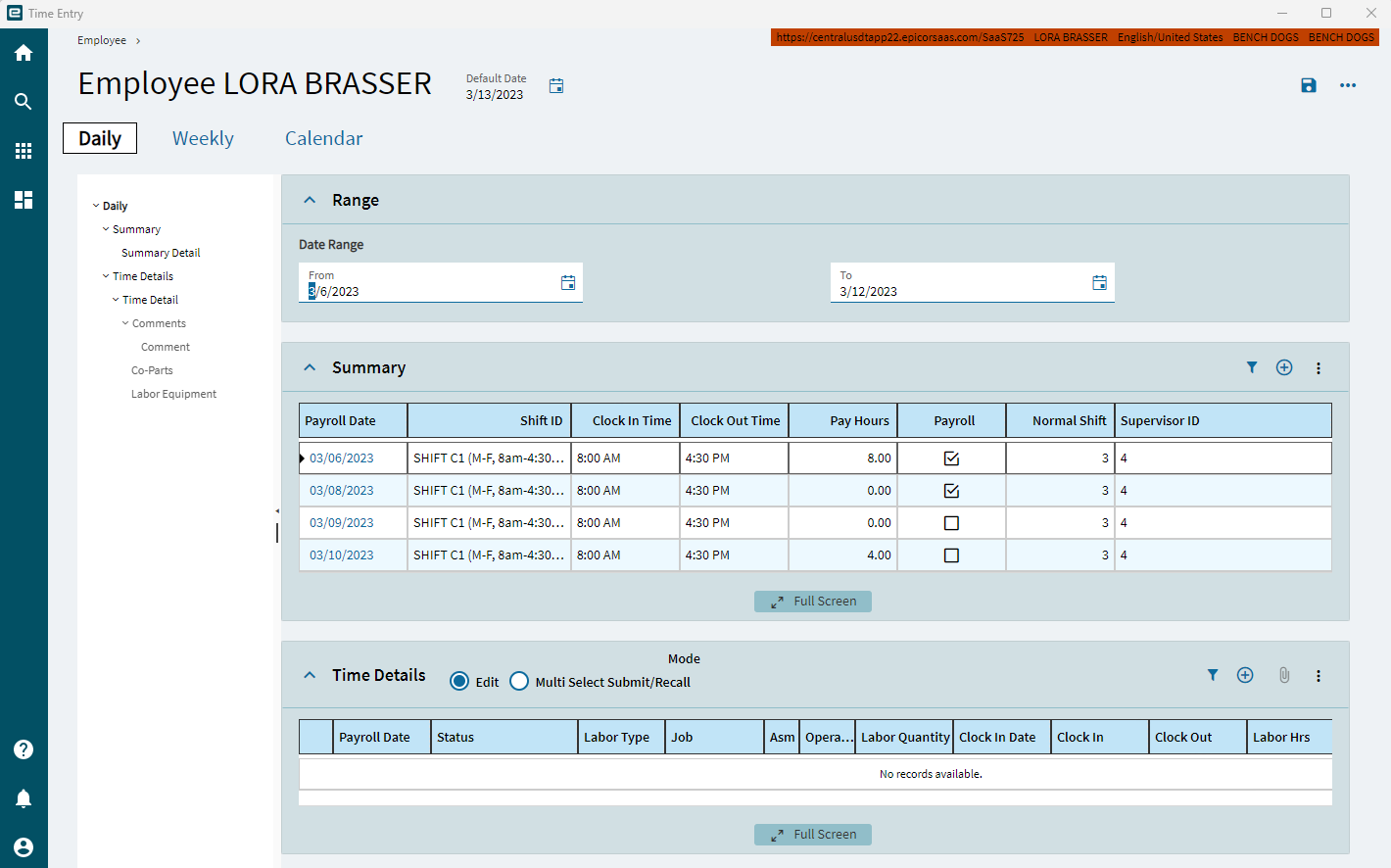

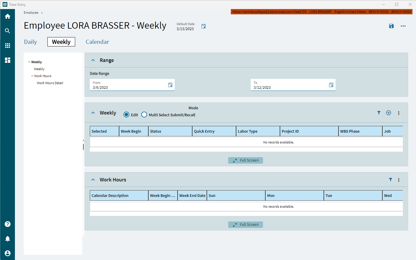

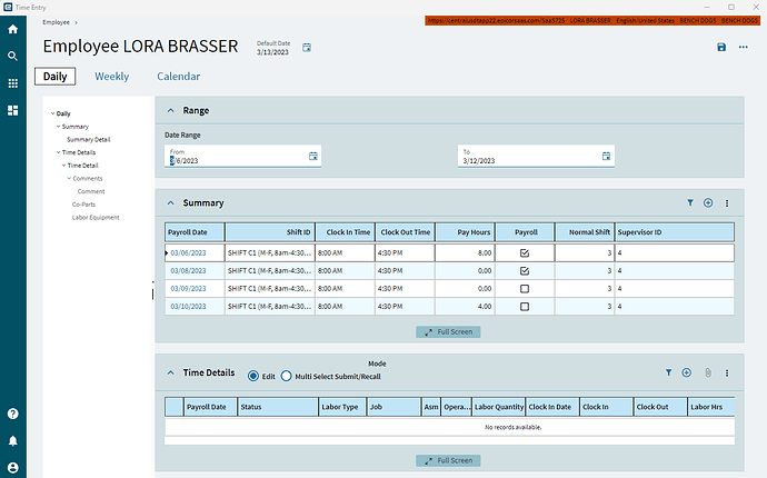

Weird…is it still there this week? The day I entered doesn’t show up now today anymore… the records are there, they just don’t show up on the calendar, or the weekly view.

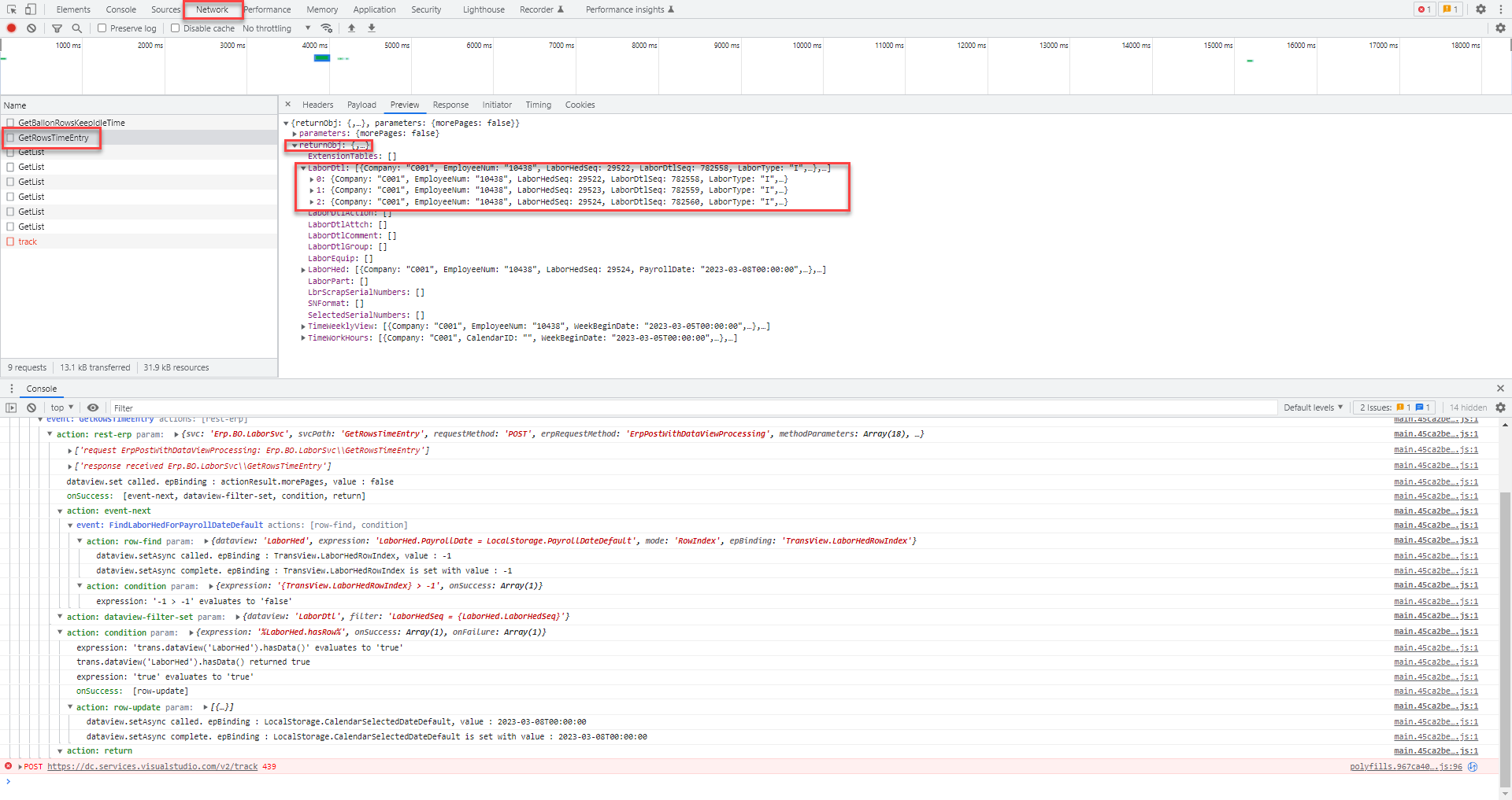

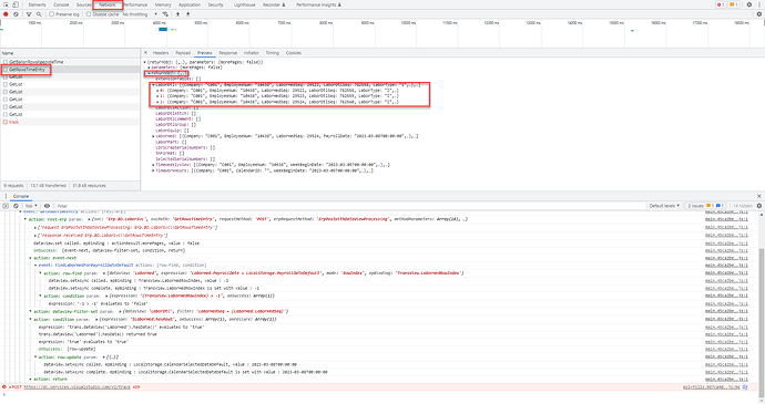

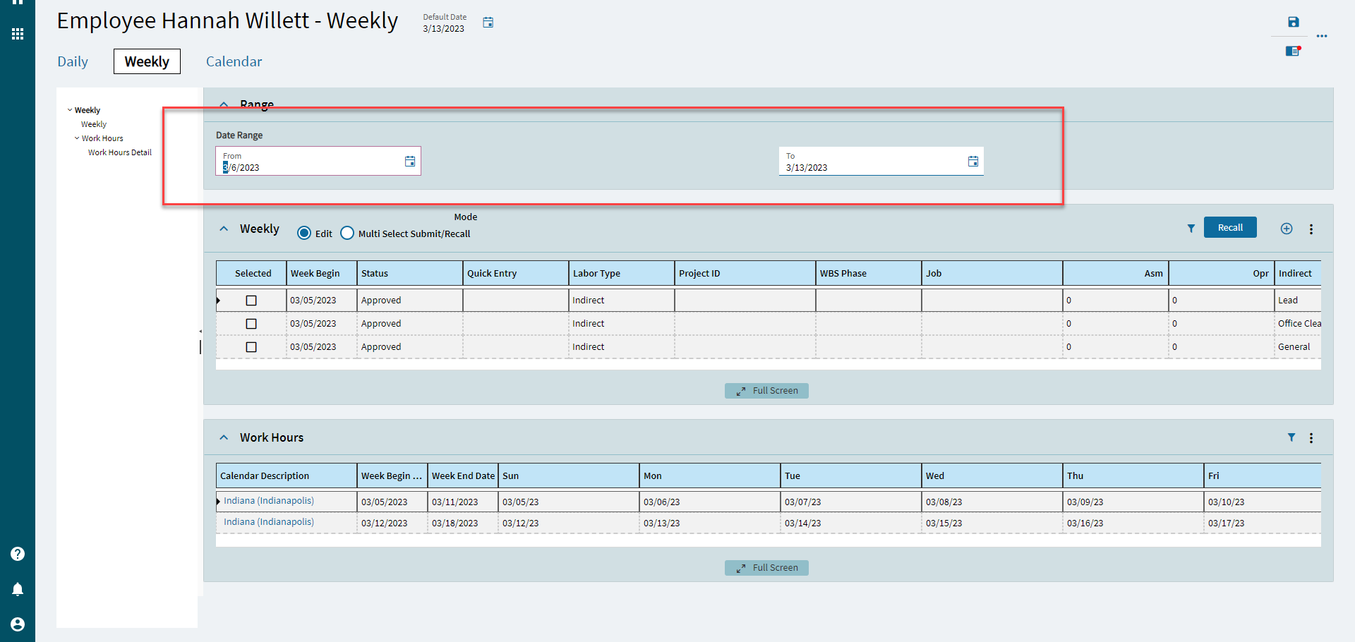

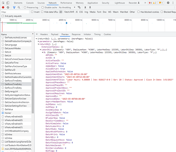

That looks like you’re using the embedded browser from the client. Will you please try it in a web browser like Chrome? When you do, please go into Dev Tools (F12), change the date to the range that is correct, go to the network tab, click on the GetRowsTimeEntry and see if there’s data?

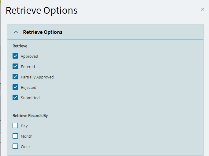

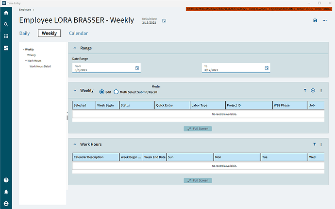

I unselected Week and the times disappeared from the calendar. I closed that menu and went back in to check it and it still had Week selected… Now selecting Week, the time doesn’t come back into the calendar view.
It turns out you need a Time Management License to see weekly time which we do not have.
