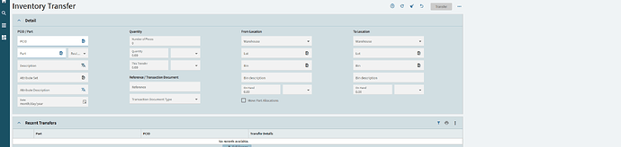

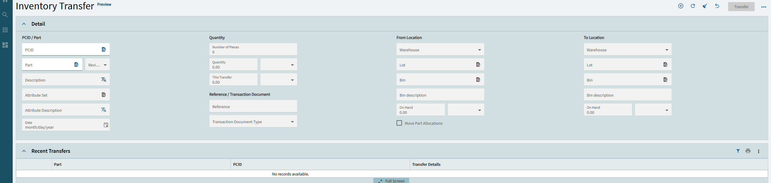

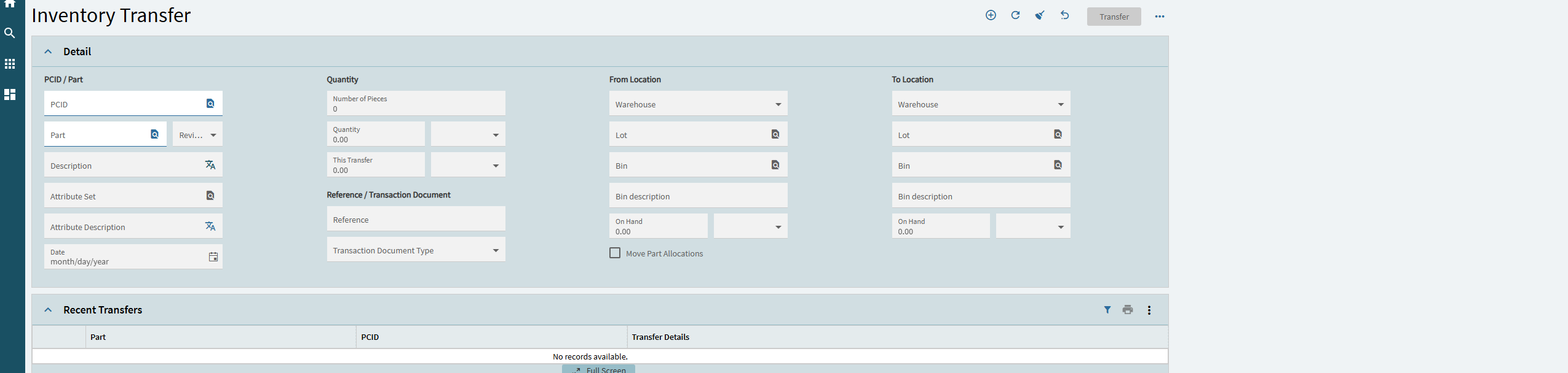

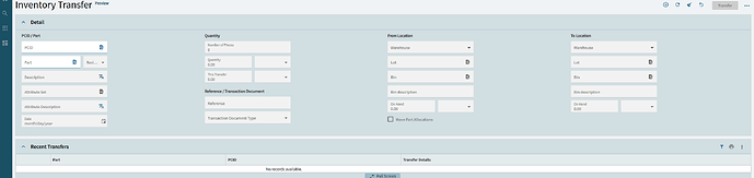

However, unless I am missing something, the browser is still not a “Full Screen”.
As an example, the Inventory Transfer screen has a lot of “blank” space to the right.
In order to optimize the window and utilize the space to the right, I have to open Application Studio and enable “Use Full Width” to maximize the space to the right.
I am not an expert with web developer tools, so if anyone has another idea on how to launch browser screens using the full width, I would be open to learning how to do this. Thanks in advance!
