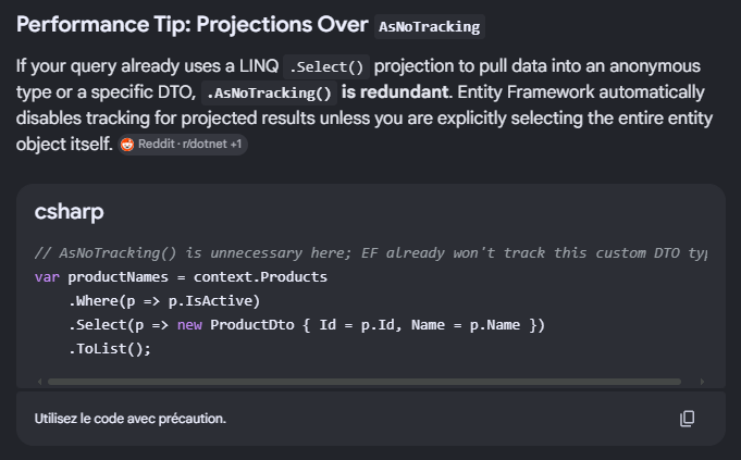

Learning something new everyday, was not aware of “.AsNoTracking”. This whole EFCore thing forces me to realize that I really don’t know what I’m doing.
Prompt Gemini about it and this part is interesting:
It would seem that “.AsNoTracking” is not necessary 100% of the time in read-only situation, if using statements such as “.Select”
Can you ask it why his JobHead is complaining about it. He is selecting a single column.
I wonder if the syntax he is using doesnt play nice.
