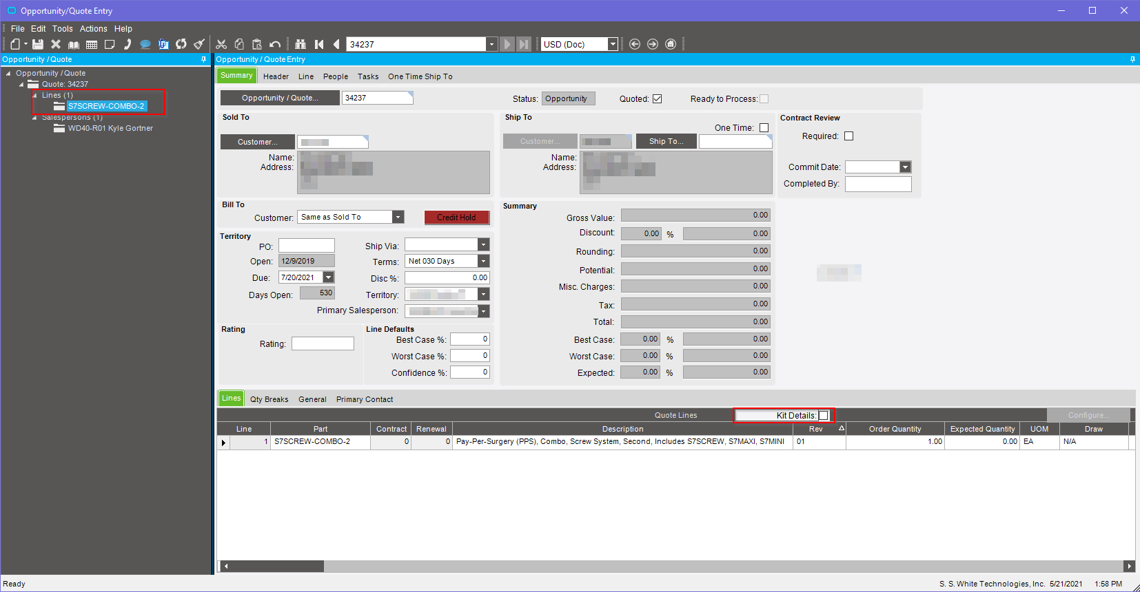

When opening the quote (that has a sales kit as a line item) in the Quote Entry dashboard, I’m only able to get the sales kit to show as one, by adding a new line. Right when I add a new line to the quote, the sales kit receives an arrow and shows it’s components

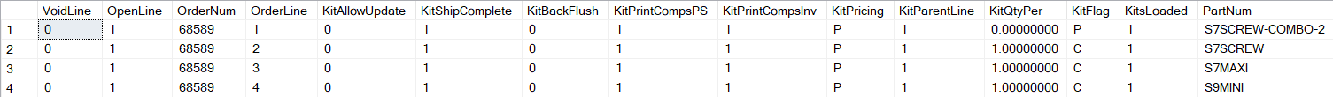

As shown in the three images above, I’m able to get the sales kit components into the QuoteDtl table from adding a new line; I can delete the new line after. I’m also able to simply click the ‘Kit Details’ checkbox and save the quote to get the components to show.

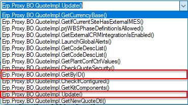

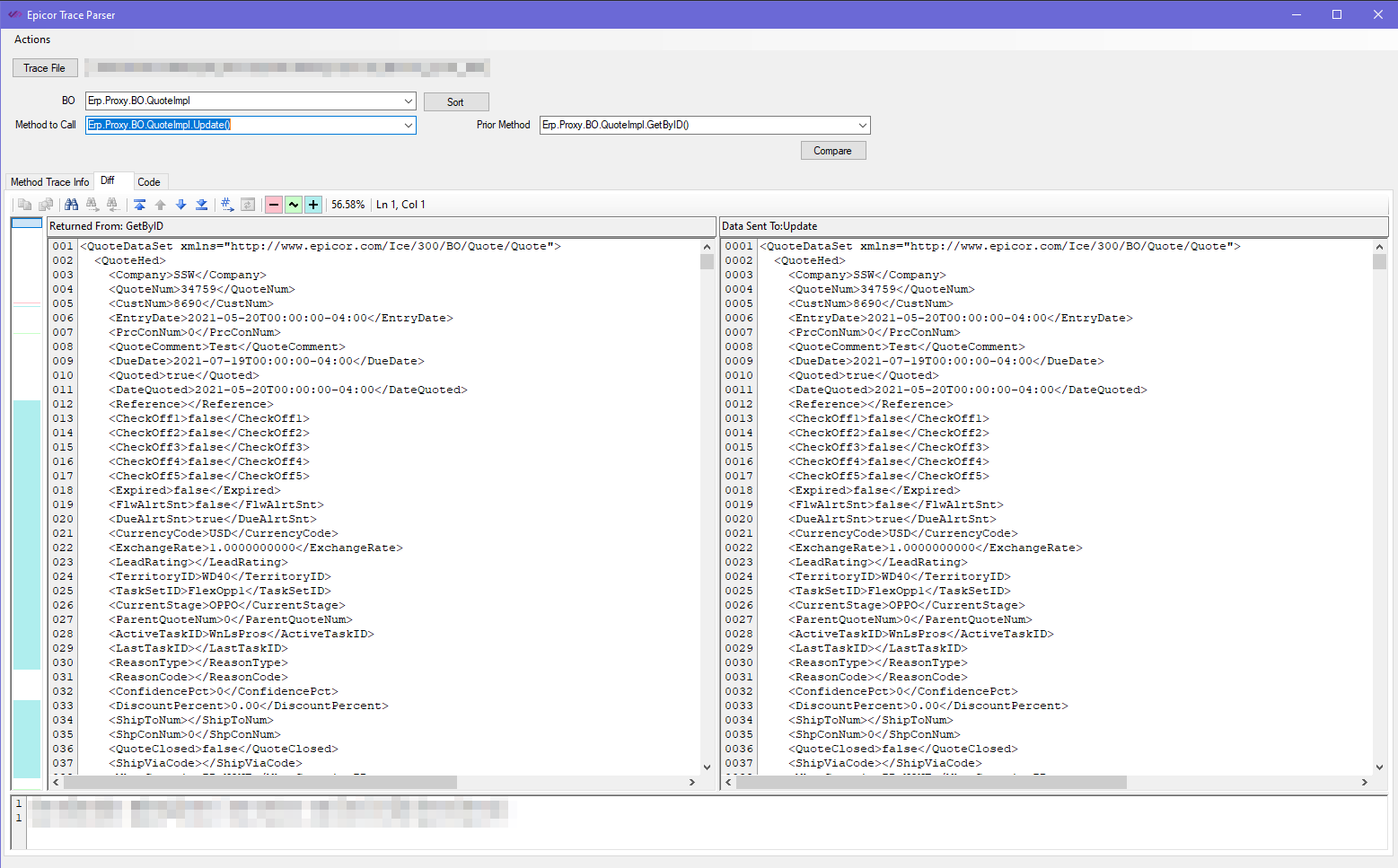

With that, I enabled tracing, and logged the action of adding the new line. I was able to use the Epicor Trace Parser to find what was being used to update the QuoteDtl table with the sales kit’s components
With this, I’m not sure where to go from here in order to get the quote to follow the same behavior as the order in terms of showing/adding sales kit components onto the dtl table by simply passing the kits’ partnum to the quote via REST.

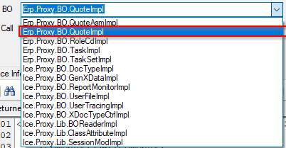

I figured out how to clear the trace logs right before doing the action I wanted to trace, in my case adding the new line - which helped a ton!
As you called it, the magic is in the GetKitComponents() method call. For some reason, I wasn’t able to pinpoint which method was pulling in the actual dataset for the components. It was probably my error, since I was trying to use the Diff tab, and compare to previous method calls.
Instead I should have just looked at the GetKitComponents method and replicated exactly how the fields are passed here:
Simply passing my POST request body following how the fields were passed in that trace to the GetKitComponents() method fired the rest of the magic!
