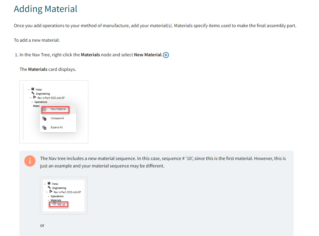

You can add kit components in Engineering Workbench, the same as any other bill of material.
Or, you can add kit components manually on the Quote or Order.
Thanks so much. If it’s not inconvenient, could you tell me where and how to set up the kit components in Engineering Workbench?
This procedure is the same as adding material to any other bill of material. The only difference is that the parent part is a sales kit.
You can find instructions in the “Adding Material” section under the Engineering Workbench help:
Also, the Engineering user guide:
https://epicweb.epicor.com/doc/Docs/Kinetic_EngineeringUserGuide_2023.2.pdf

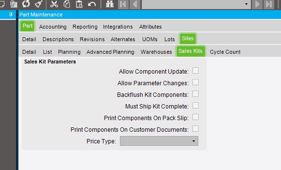

Also make sure in your part setup you check the correct selections for your kit. In conjunction to creating a KIT BOM in engineering workbench. Make your sales department confirm that all the KIT components populate correctly, or it will create a mess in inventory and generating 100% GM.
