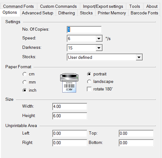

When printing to either of these printers with a 4x6 label, it cuts off a quarter inch of the label. There are no margins set that would restrict the label from using the full 4x6 layout.
When viewing the document in print preview, it fills the full 4x6 setup without any cut off. But as soon as it prints it is missing the last bit.

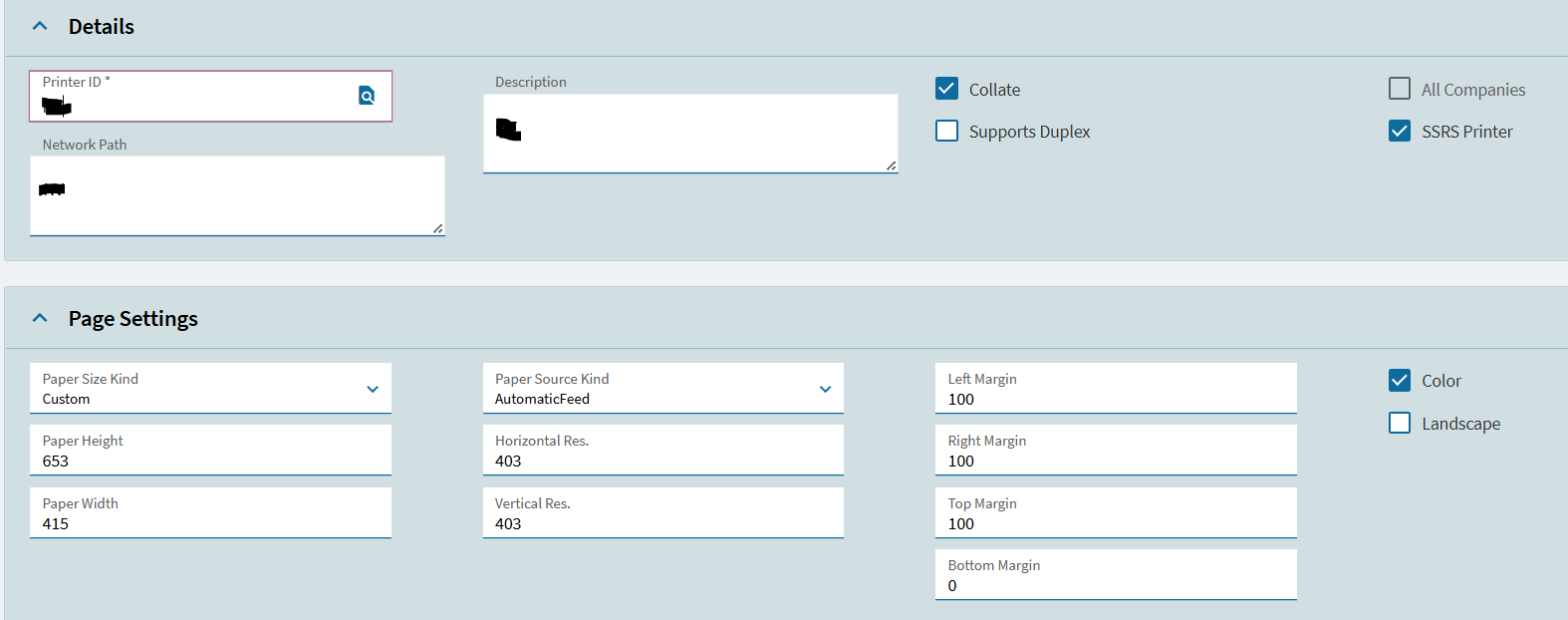

Are you using Client Print or Network Print? We have our Zebras running as network printers - Printer Maintenance setup below. Zebra drivers installed on our app server…settings also below.
@JMPCONJ we are using this separately from Epicor and instead using Print Station / Print Portal.
The dream is to get it all set up and integrated with Epicor, but for now its just stand alone.

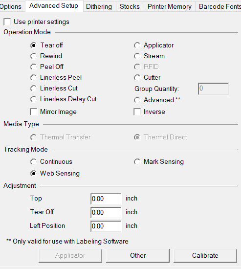

Hm…on ours we have zeros in the Unprintable Area and Adjustment fields. That’s about all I see on my screencaps that match up.
