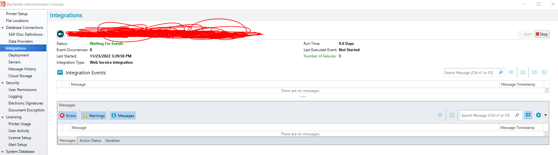

I know this screenshot doesn’t show any steps, but if you are in this screen and you initiate your integration you should see the steps that it is taking in these grids.
