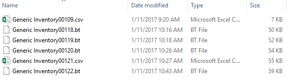

# Label RDDs Wrong Keys (Report Data Definition) **Category:** [Epicor ERP 10](https://www.epiusers.help/c/e10/5) **Created:** 2017-01-11 16:04 UTC **Views:** 768 **Replies:** 2 **URL:** https://www.epiusers.help/t/label-rdds-wrong-keys-report-data-definition/36860 --- ## Post #1 by @hkeric.wci Is it me or do all the Label RDDs such as **GenInv, GenShip** have the incorrect Key specified in their Relationships. There is a **PK_Company** if you manually try to add it, but not just plain **Company**. What's happening on my end is that the .bt (BarTender) files that are generated are getting more records than they should do the incorrect Key it is joining on more rows. I can of course rewrite it but the question remains why is it broken :) out of the box. --- ## Post #2 by @Randy It is odd, the system default has a Key, but the custom ones we made we cleared the Key so it's blank. I didn't do these RDDs so I can't say for sure but we maybe did run into the same thing. [image: pasted2] --- ## Post #3 by @hkeric.wci I rebuild my own, not even sure why they would join on PartBin and PartWhse if it is meant for "Labels" because the PartTran pretty much has everything in regards to GenInv. --- **Canonical:** https://www.epiusers.help/t/label-rdds-wrong-keys-report-data-definition/36860 **Original content:** https://www.epiusers.help/t/label-rdds-wrong-keys-report-data-definition/36860
