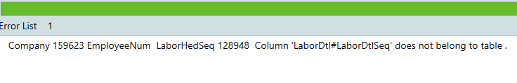

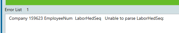

I get this error:
100% sure on the Employee number.
How can I post LaborHedSeq?

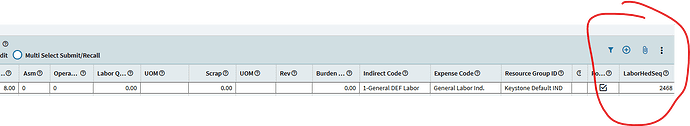

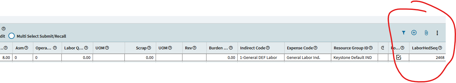

At the grid level you can choose personalize and add [LaborDtl].[LaborHedSeq] to the column so that you can see it.

I tried the highest HedSeq+1 and I get this error.
LaborDtlSeq isn’t in the table, I can’t understand why it gives me an error.
