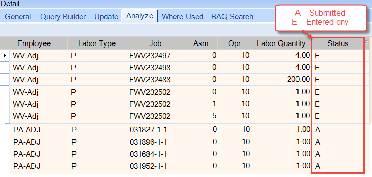

Any way to enter labor entry hrs against different jobs and them highlight each entry and mass submit? Currently in E9, i use the labor entry to fix qty variance for jobs that are completed but some of their operations are missing. Meaning during labor reporting , some of the employees forgot to report qty against the job operation. In E9, i used to get all the variance between Run Qty and Completed Qty and mass upload them using template in labor entry. Once mass uploaded, highlight all entries and click Submit.
But in E10, i mass uploaded all the variances but when i highlight all and click Submit, only the 1st row is Submitted/Approved. How can i submit / approve everything i entered with 1 click. The Employee used to do these qty variance is a dummy employee id with no labor rates.

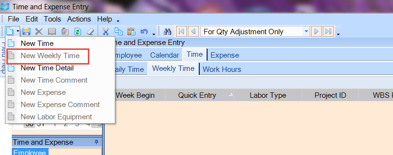

Thank you for quick reply and suggestion. Yes, the entries are all done in a single day, say for example every Friday, so the date range will be within 1 week. However, when i tried to create new weekly time, the option to do so is greyed out. Is there somewhere i need to check off to have access to enter weekly time?
Hi Al,
You need to create the “Payroll Header” first by selecting the Monday on the calendar and then do New Time. Once you do that, you can add Weekly or Daily time.
Mark W.
I believe that the weekly and expense tabs require an additional license.

It looks like additional License may be required as Brad mentioned. i did create the Payroll Header but only option available was New Time Details which is only good for daily labor entry time. i have no problem entering daily times but issue with E10 was not able to submit everything i entered at once like i was able to in E9. In E10, even if i highlight all the rows i entered and click Submit, only the last Row is “Approved”. So, i have to do it line by line.
We’re a manufacturing Company and use hundreds of jobs which has multiple operations per job. So when our shop employees report time, sometimes not all the qty completed will match job operation qty. In order to remedy that, i used to take a variance between the Job Operation Run Qty and Qty completed (reported via timesheet) and use the labor entry module to mass upload(paste update) Job, Assembly, Operation and Qty (variance calculated) for jobs that are shipped or received to stock. There are hundreds of jobs that would need this correction, so submitting each line would be extremely time consuming…
