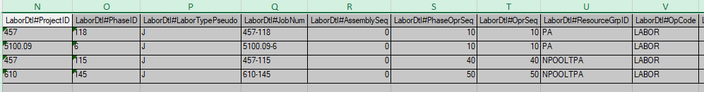

I am trying to build a DMT template for TE Labor Combined DMT. I am extracting the data out of our live system for use in a test environment. I thought I had it right but when I try to load the data (just 4 records for now) it gives me Invalid Job Operation Sequence errors on each line.
The fields/columns I have in my DMT are a combination of the data I know I need plus fields suggested by articles from this site. Here are the fields I have:

I have valid operation sequence numbers in both the PhaseOprSeq and OprSeq columns. I have the job number, project ID, phaseID, OpCode.
Does anyone see why I am getting the Invalid Job Operation Sequence error?

Thanks. That got me past the job oper error but now I am getting this one:
This Job is a job type of Project. Entry not allowed for non-project related transactions.
Does this mean I can’t DMT in the LaborDtl data?

Yes they are there. Now that I have moved some columns around I am now getting “This Job is a job type of Project. Entry not allowed for non-project related transactions.”. Of course nothing indicates what is wrong.
