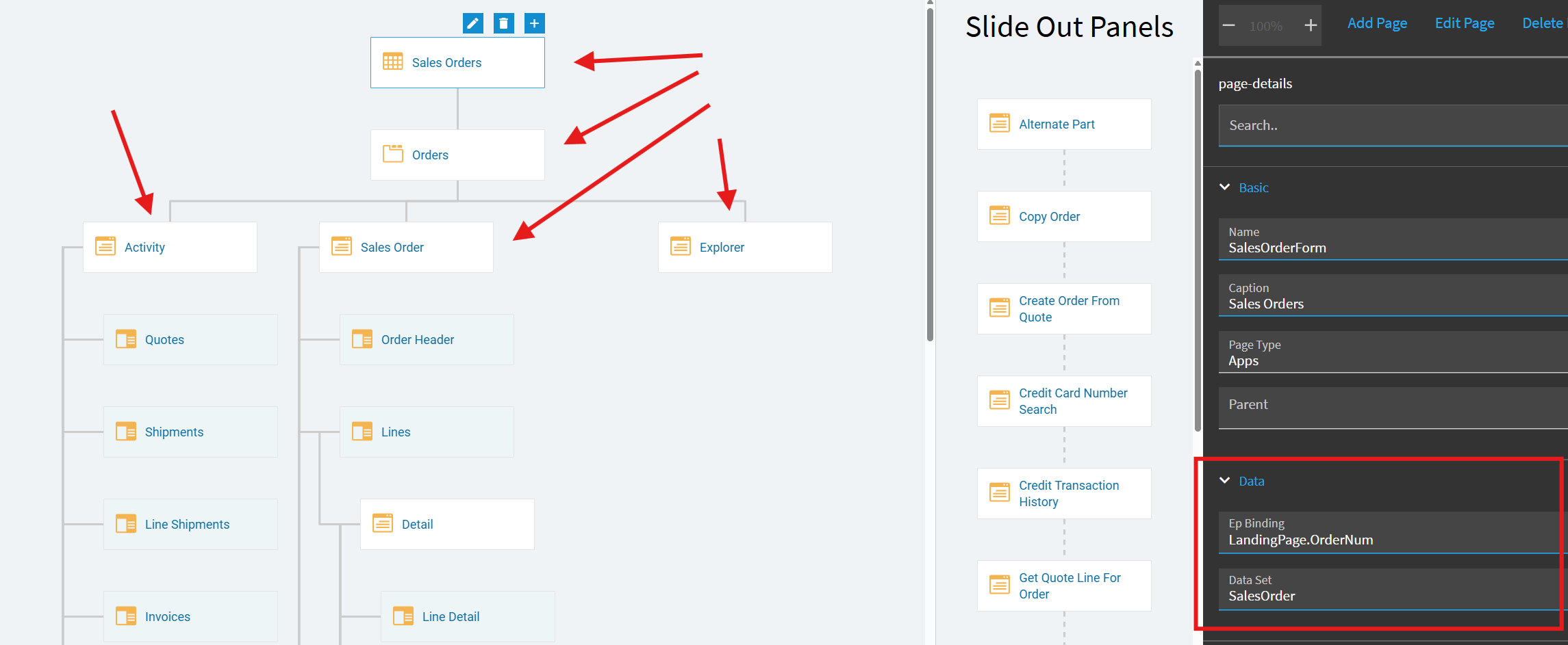

Yes, there is a specific reason (bug). Sometimes when you save a layer, the EpBinding to the page is erased. I don’t know why. Go to your layer and make sure the EpBinding for all the main pages exists (the ones with arrows in the image below). If it’s blank, those buttons will disappear.

it looks like all the epibindings are set, but still nothing.
