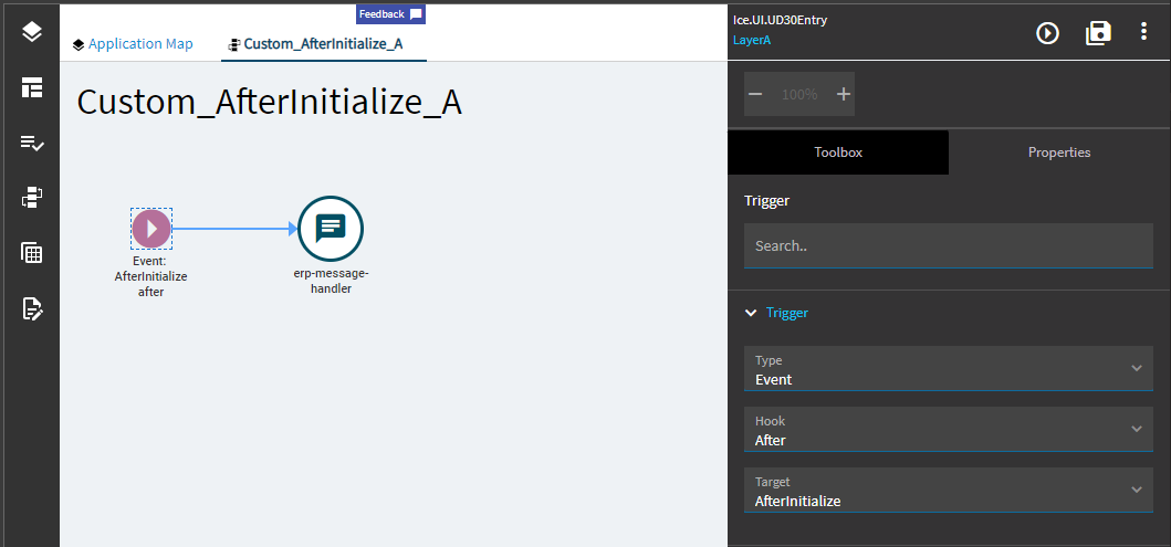

You create a LayerA with a custom event that is triggered after the system event AfterInitialize. The custom event action is to display a Toast message ‘A’.

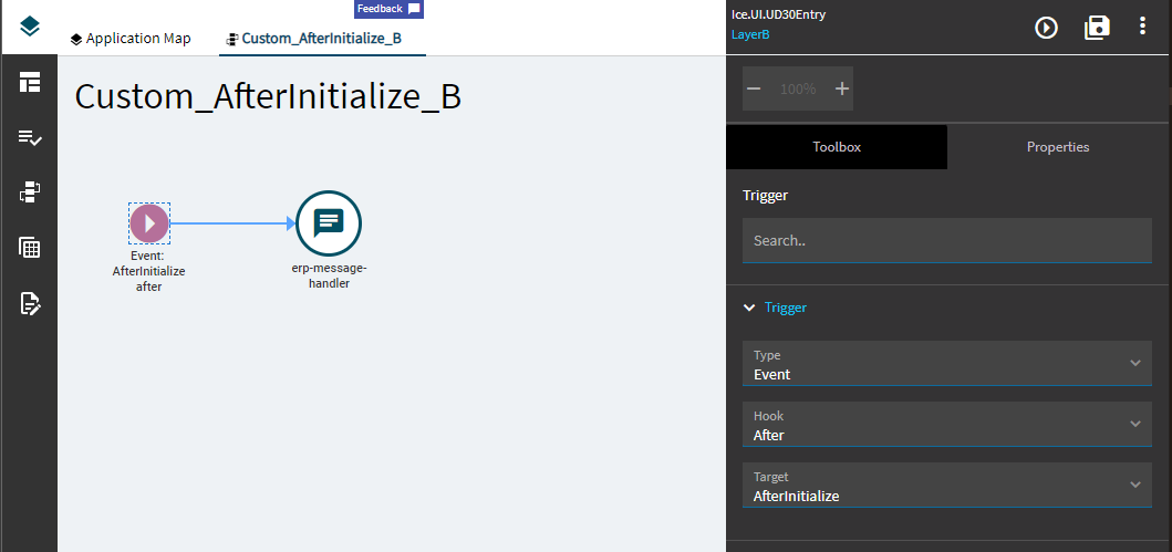

You also create a LayerB (independent of LayerA) with a custom event that is triggered after the system event AfterInitialize. The custom event action is to display a Toast message ‘B’.

I have attached the JSON generated when LayerA is applied first, followed by LayerB, and vice-versa. You can see both custom events in the JSON as expected, in the correct order … but only one is executed.
