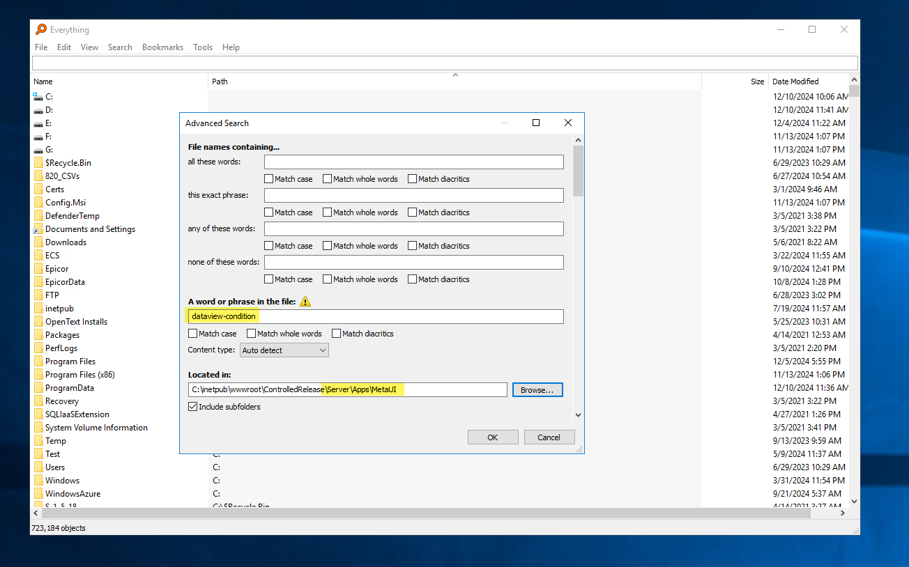

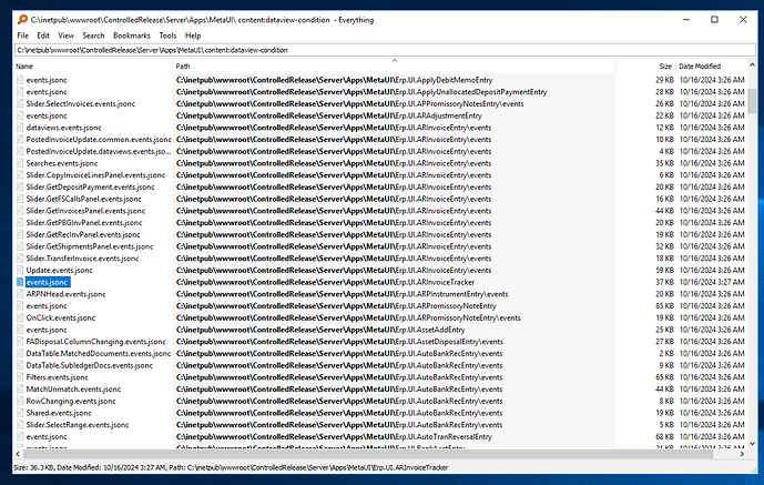

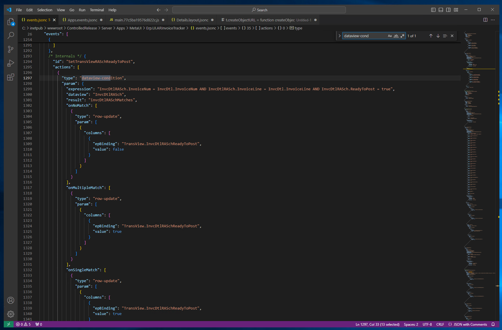

Typically, I just search for the widget in question to see how they set it up. Finding a good example would show you both how they configure it and what syntax they used.
Here’s an example for a dataview-condition:
Pick one. Any one. If you don’t find what you need, go pick another one.
