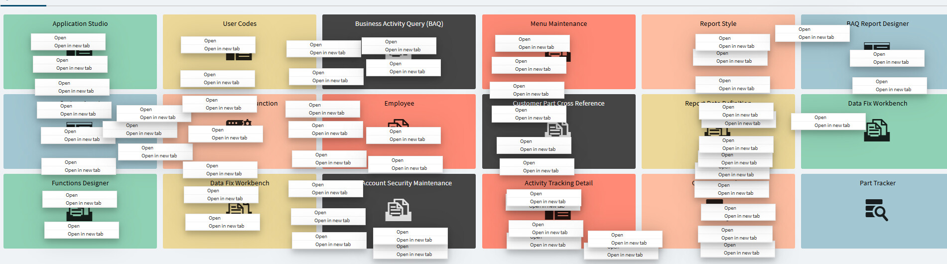

Has anyone else been experiencing the left click “Open/Open in new tab” staying on screen even when you click somewhere else?
:headstone:

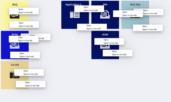

We’re version 2026.100.9, I’m not sure when I first experienced this, but I left click to open in new tab a lot and it happens pretty frequently for me. It happens in edge and chrome. Also, happens for different users and in private browser tabs.
I can reliably unlock this level by switching between my home screen tabs, then left clicking to my heart’s content.
If I open an app in the same window, the menus will appear in that app. If I refresh the browser, the menus go away.
Seems harmless enough, mostly annoying…

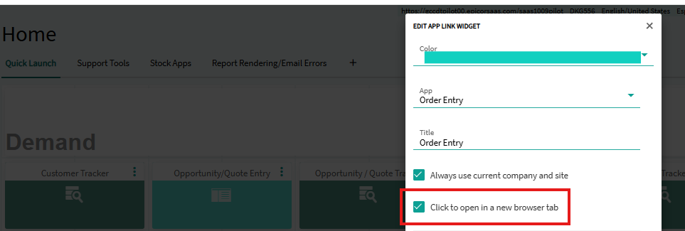

You can also set the tiles to always open in a new tab now so that you don’t get these annoying pop-ups. This made our users very happy.
