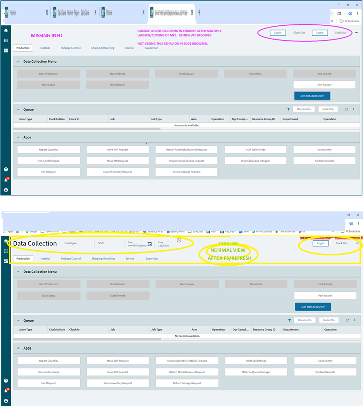

An update to this issue where the MES/Data Collection URL was opening the Office/Homepage instead of MES/Data Collection in Pilot on Linux. We opened a ticket with support and after initial attempt to resolve there was a pending conversion that appeared to be stuck in the “started” state that popped up when logging into Pilot. Per Epicor support, they applied a hotfix and also the conversion now displays as completed and the MES URL is working. I did notice some strange behavior in Chrome, per attached, where the login button in PILOT MES is doubled and the top half of the form is missing. A browser refresh/F5 resolves the issue. I deleted all browser history but the issue comes back after a few launches of Pilot. We are seeing the display issue in PILOT in Chrome only. We are not seeing the issue in Live in Chrome. Also, we are not seeing the issue with Edge browser in Pilot or Production.
Thanks for confirming that the hotfix fixed the issue and reporting back some oddities on the display side.
