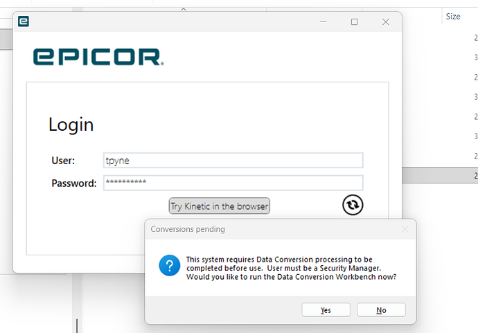

Cleared the personalizations then logged out and back in and got this.
Epicor did do maintenance last night and sent an all clear…
That almost seems like they are in the process of updating your environment?
I agree, this reads like that to me.
And this is dumb.
Epicor did maintenance last night on Pilot and we got the all clear.
I was able to work this morning until I logged out…

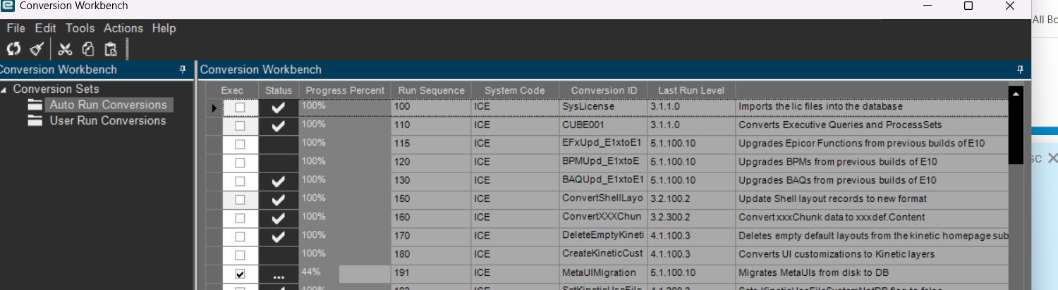

And now this is stuck at 44%. I honestly do not know what they are thinking.
But I am effectively shut down. I can’t develop or test any of the items they pushed on us recently (FTP, Linux containers) or Kinetic conversions. Or gee like work for my company that is not related to Epicor upgrades.
The Classic shortcut at least will take me to the conversion workbench.
If I browse in Kinetic it gives the same error but does not take me to the workbench it just gives this.

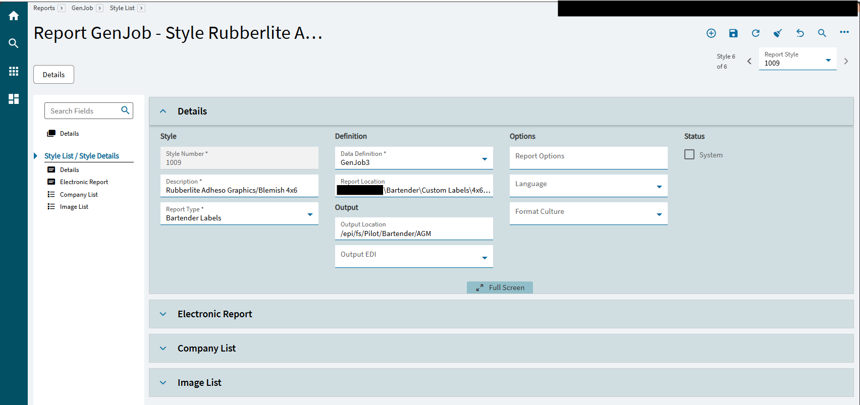

Sorry anyone if you see this multiple times, but there have been multiple threads with this issue. I was able to get my labels working in Pilot by updating the Output Location in Report Style from:
\tenantid.file.core.windows.net\tenantid\Pilot\Bartender\AGM
to
/epi/fs/Pilot/Bartender/AGM
So, replace anything that has '\tenantid.file.core.windows.net\tenantid' with ‘/epi/fs/’ and it may work for you.
