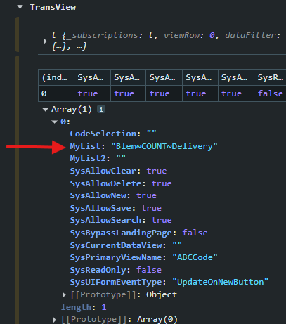

It is going to add those values to the TransView dataview, in a column called MyList.

If I look at the value stored in my TransView dataview, I see the compiled tilde-delimited list:
