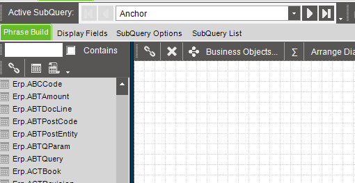

You need a recursive subquery/CTE that generates a list of dates between a start and end point. That means creating the anchor subquery, then a union all subquery tied to the anchor. Then join the anchor to your data.
/*This is a CTE subquery.
It doesn't have any tables in the phrase tab.
Just one calculated field.*/
with [Anchor] as
(select
	(@Start) as [Calculated_Date]

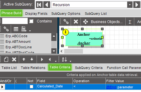

//UnionAll subquery that uses Anchor as its only source table.
//Don't forget the where clause, otherwise this thing loops forever.
union all
select
	(DateAdd(D,1, Anchor.Calculated_Date)) as [Calculated_Date]
from  Anchor  as Anchor
where (Anchor.Calculated_Date < @End))

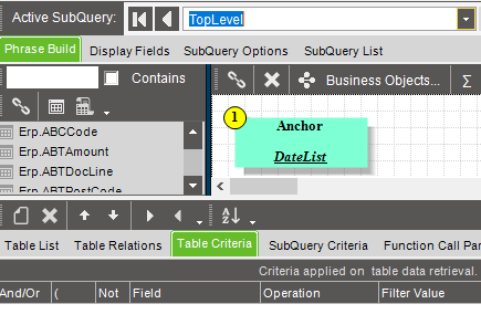

/*This is a basic top level query that merely outputs the CTE
You'd left join your real data to this to get an inclusive list.
Just make sure you account for nulls.
That will happen when you have nothing to report on that day.
ISNULL() is your friend here.*/

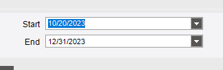

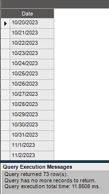

select
	[DateList].[Calculated_Date] as [Calculated_Date]
from  Anchor  as DateList
