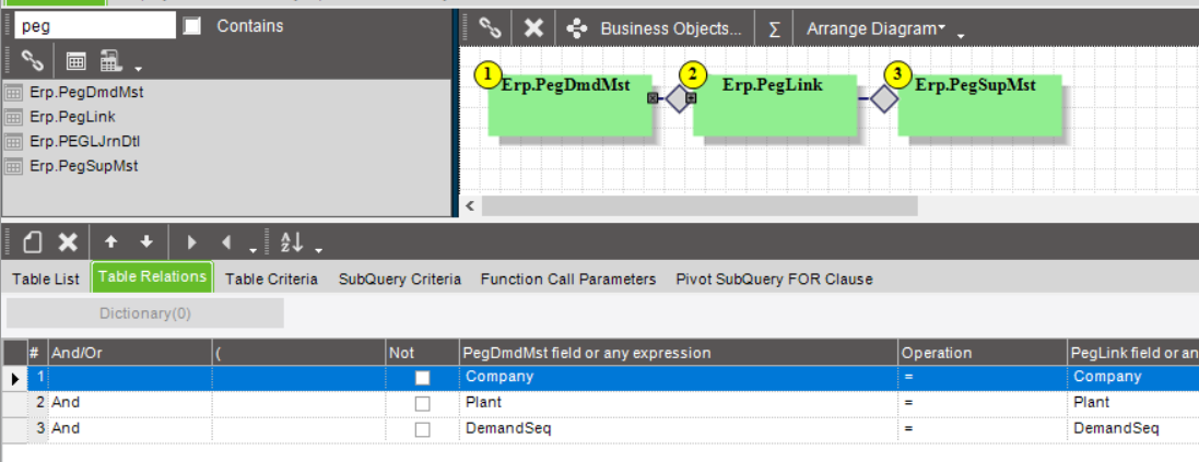

The 3 pegging tables link together in this manner:
The Link table in the middle allows for many-to-many connections between demand and supply.
