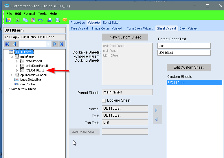

You can use the Sheet Wizard to add a new sheet:
Then add an epiUltraGrid to that sheet, and for the binding, select ListView
And get:
NOTE
Like a regular UD table(i.e. non-Parent/Child), you’ll only see records for the parent when they are loaded via a search. However, loading a Parent record will load all the children for that parent.
Note #2 … It doesn’t seem like you can delete the parent from the List tab. I had to go back to the Detail (Parent detail) tab. I could then delete it from there.
