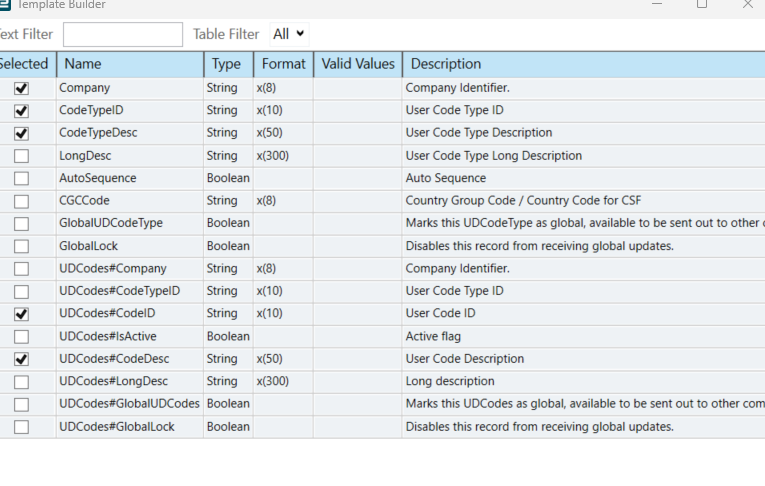

is there a way to load user code in DMT. I tried and it doesn’t work. it only create Code Type but it doesn’t create Code ID under the Code Type.

Never tried, but I assume you need #Company
and #CodeTypeID
also. I know it’s redundant, but I think that’s showbiz.
yes, i figured it out.

I’m not seeing the option for User Codes in my DMT. What section are you seeing it in? I have the User Codes module but just not in DMT.
Under Management > System > User Codes
Thanks! so strange though i don’t have User Codes in there. but for sure i have the module licensed.
With UserCodes - I have found Paste Insert to work really well.
You can also do it with a solution
