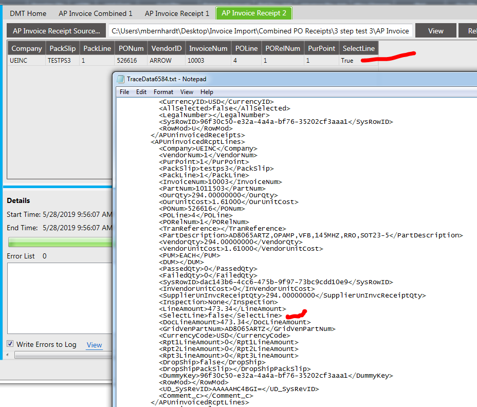

Thanks Darren, this template is doing the same thing. While poking through the trace log I noticed that it’s not passing ‘SelectLine’ to the business object correctly so I opened a help desk ticket. I don’t know which version you’re on but I wonder if it’s broken at this time.

Hi Mark
Did you try using bit format for that field (0/1) instead of the True/False

Thanks Darren but it did not help, last week it was elevated to a problem PRB0213286
This section of DMT is a hot mess, misc invoice line GL mapping on version 4.0.43.0 did not work, I had to revert to 4.0.42.0. Today I tried the brand new 4.0.44.0 and the misc invoice issue is fixed but this line type R issue still remains.
