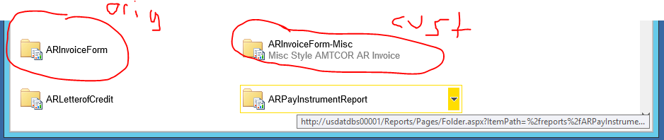

The help said to put the folders with your customizations at the same level as the originals. I.E.:
Or should there be a folder named "Custom Reports" at the same level as the reports folder, with the all the custom report's folders in it?
Like:
SSRS
+- Reports (folder)
| +- ARInvoiceForm (folder)
| +- ARLetterofCredit (folder)
| +- ..... (and the rest of the original folders
+- Custom Reports
+- ARInvoiceForm-MISC (folder)
+- ..... (and the rest of the folders for custom reports
## Post #4 by @josecgomez
The CustomReports at the root of the Reports folder (its already there, this is where BAQ Reports go normally) then in there create the folder... that folder is "Guaranteed" to be safe on upgrades
