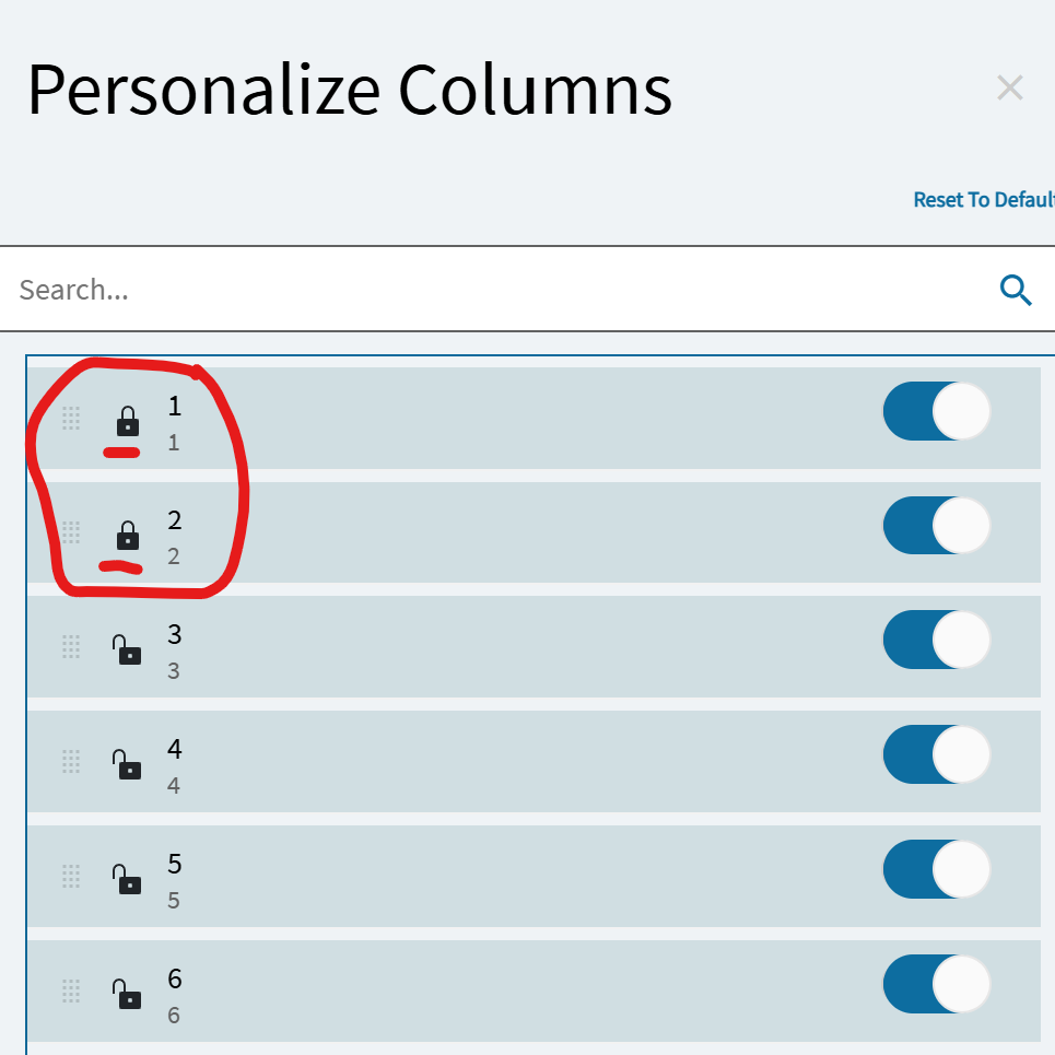

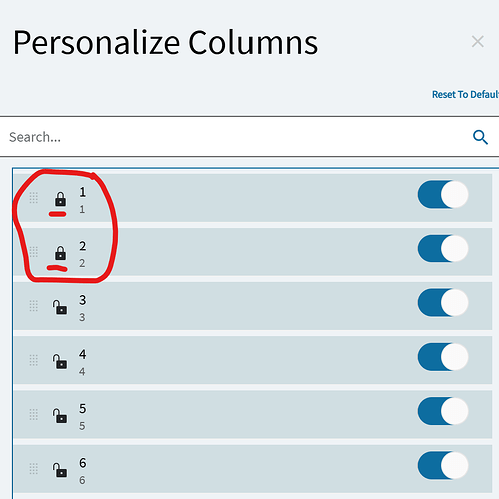

Figured out the columns thing. Turns out I had to add build out the total columns needed for the dataset within the grid model. Thankfully this is easy as the columns come in numerically labeled. So after creating 120 columns in this grid, setting it to be able to display 200 so all 120 show and loading the data I can see the columns listed in the personalization section. Thus the user can now lock those columns to the grid using this setting:
