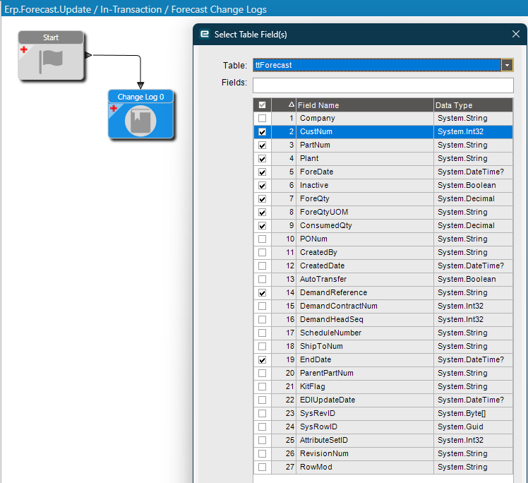

We have enabled the change log on the Forecast table (on all fields). It properly logs new records and all changes users make in the Forecast menu to forecasted quantities and the inactive checkbox. But it does not log changes to the ConsumedQty field (again, it’s included in the log!). This field cannot be edited directly by users, instead it’s updated by the MRP/Generate Suggestions process. Any idea why this does not trigger the change log? Any ideas how one could enable change logs to this field?

I think this statement tells your story. A Change Log (I’ve always assumed) is triggered by a User action. The log then records the change and the User responsible.
As you stated, ConsumedQty is not a field that can be edited directly by users. Its not a USER changing the value, it is the MRP engine. Its basically a calculated field.
If you want alerts when the value changes, you may be able to do this with a BPM on the Forecast BO.

To Eric’s question re: logging: Not sure, how this was done but I think a consultant enabled logging on the Forecast table for us (before my time). It’s working on most fields users can change via the menu but not on the system calculated ConsumedQty field…
