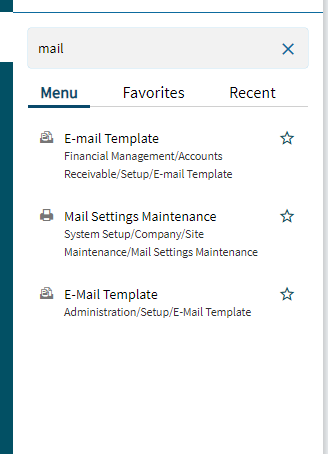

I don’t have that module…
Do i have to enable it somewhere?
We use APR to send invoices so it’s easy to add a Bcc. But, the system mail log is a menu item like @aosemwengie1 posted.
I do not have this menu item. Did you have to enable it somewhere?

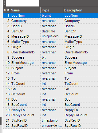

What version are you on? The data is getting stored in Ice.MailLog or something like that even if you don’t have the UI.

Do you happen to know what table stores the Email message? I see a MessageID column on the MailLog table, but i just don’t see a table that you can link that with.
The email body isn’t stored, if you need that then you need to be sending the emails to a mailbox where you can retrieve them later.
Do you happen to know anyway to correlate a given Mail log to anything else?
Does the Mail log UI let you filter by customer ID or Invoices, because the Mail log table does not seem to have any information that lets you link it back to the event that caused the email to be sent?
No. You’d need to add a BPM or function to customize it if you want to do that. Or, just Bcc to a mailbox.

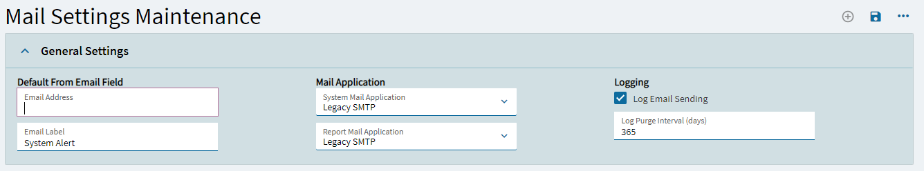

Here’s what the log shows. It’s pretty simple.
We’re doing SMTP/365 emails from Kinetic…so I can just open Outlook to the mailbox of the sending address (we only use one, not personalized) and find whatever message I need. You could probably export a list of sent messages for a specific timeframe and build a report from that.
