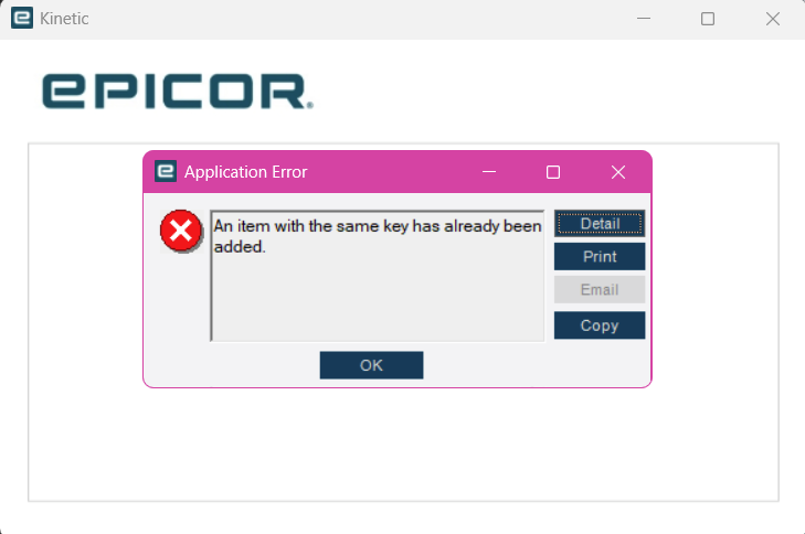

Classic login screen, there’s no prompts because we use Azure credentials. It’s been working for months, then this morning I get this:
“An item with the same key has already been added.”
I’ve cleared the hidden folder in C:\Program Data. I’ve even used Remote Desktop to the App server and recycled the app pool. (this is our Dev environment). There doesn’t seem to be a lot for me to check. Any ideas?
What did the detail say?
System Information
AppServer Connection: https://dev.epicor.onlinemeridian.com/EpicorERP
Form Name: ShellMenuForm
Customization Name:
Menu ID:
Software Version: 4.3.100.15
Application Error
Exception caught in: mscorlib
Error Detail
##!Message:##! An item with the same key has already been added.
##!Program:##! CommonLanguageRuntimeLibrary
##!Method:##! ThrowArgumentException
Client Stack Trace
at System.ThrowHelper.ThrowArgumentException(ExceptionResource resource)
at System.Collections.Generic.Dictionary`2.Insert(TKey key, TValue value, Boolean add)
at IceShell.SessionManager.loadHistory()
at IceShell.SessionManager.loadUserSettings(String userID, Boolean changeUserEvent)
at Ice.Lib.UI.SessionCache.set_CurrentSession(Session value)
at IceShell.SplashScreenApp.logon_LogonEnded(Object sender, EventArgs e)
at IceShell.Apps.LogonDialog.OnLogonEnded(Object sender, EventArgs e)
at IceShell.Apps.LogonDialog.AutoLogOnUser()
at IceShell.Apps.LogonDialog.LogOnUser()
at IceShell.SplashScreenApp.ShowSplash()
Is this just your problem, or all or more users?
Not just me, it is affecting at least one other. But I am now talking with one who got in.
