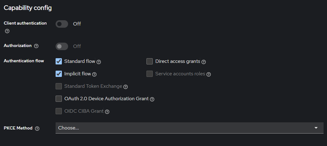

1.2 Browser (ā€œWebā€) client, implicit flow
This is what the Kinetic web app uses. Think the new Kinetic UX Authentication flow.
  • Client ID: epicor-kinetic-web
  • Public client (no secret, ā€œclient authentication offā€)

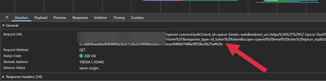

  • Enable the Implicit flow (Kinetic requests response_type=id_token token)

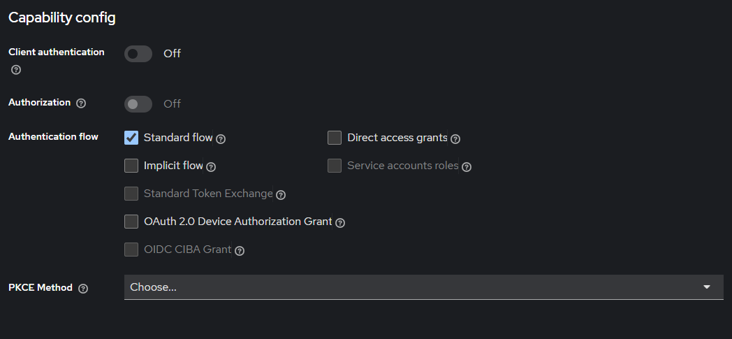

1.3 Native (ā€œdesktopā€) client, authorization code + PKCE (Think Epicor Classic)
  • Client ID: epicor-kinetic-native (These are ID’s I chose, they can be whatever you want)
  • Public client (uses PKCE, no secret)
  • Enable the Standard flow (authorization code)
  • Valid redirect URIs: https://notused and https://notused/* (you may need others for EMWW)
    • Epicor’s desktop client uses the literal placeholder redirect https://notused and intercepts it internally. It doesn’t need to be real, just registered. If it’s missing (or the Native App ID is blank), you get a 400 Invalid Request with no client_id in the URL.

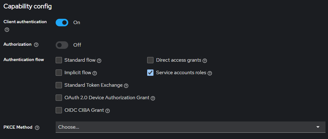

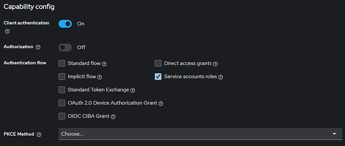

1.4 Server client, client credentials
The app server makes back-channel calls to the IDP to get user info (Email) it needs its own client
  • Client ID: epicor-kinetic-server
  • Confidential client (client authentication on), Service Accounts / client_credentials enabled
  • Grab the client secret (you’ll paste it into Epicor, which stores it encrypted)

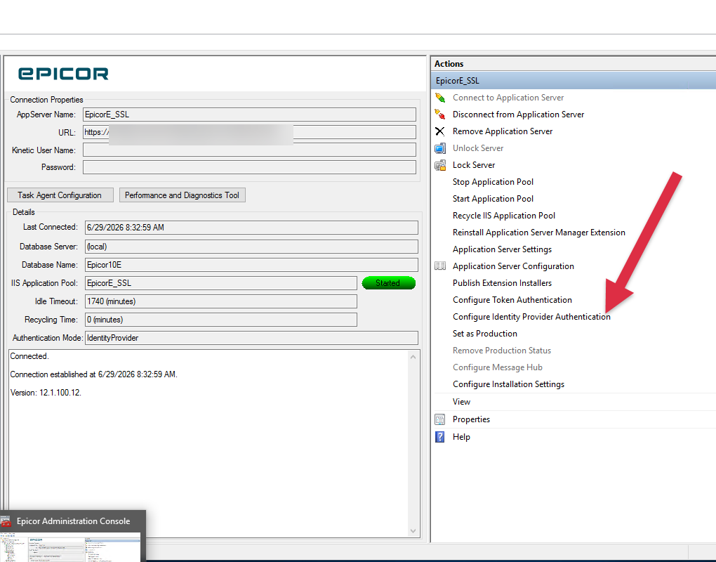

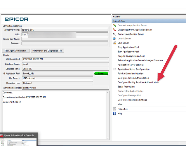

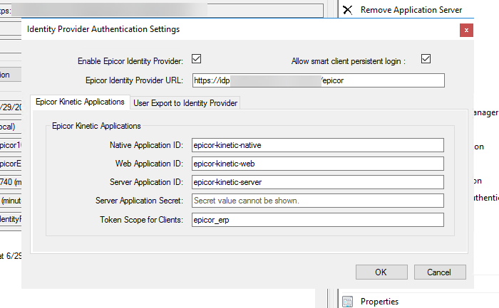

2.2 Fill in ā€œConfigure Identity Provider Authenticationā€
Epicor Administration Console, your app server, Actions, Configure Identity Provider Authentication. These fields write to the Ice.IdentityProvider table, and the secret is encrypted for you.
Epicor field Value (Keycloak example)
Enable Epicor Identity Provider checked
Epicor Identity Provider URL https://idp.yourcompany.com/realms/epicor (exact iss, case matters)
Web Application ID epicor-kinetic-web
Native Application ID epicor-kinetic-native
Server Application ID epicor-kinetic-server
Server Application Secret (secret from 1.4)
Token Scope for Clients epicor_erp

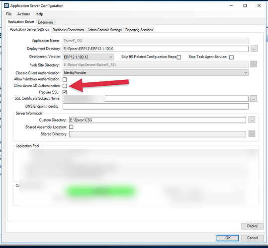

2.3 Disable Azure binding (if you have it)
This one surprised me. Azure AD and IdP are mutually exclusive as the primary login on a given app server. The Kinetic client picks ONE token method via an exclusive if (Azure) … else if (Windows) … else if (IdP) chain, and Azure wins. So while Azure binding is on, IdP never appears in the dropdown.
The nice thing is that most / any IDPs including Entra itself can be configured to work with OIDP so if you go this route you can still use Entra.
Administration Console, App Server Configuration, uncheck Azure AD.) Basic Auth stays available as a fallback, so you don’t lock yourself out. (No I didn’t do this why do you ask? :eyes::crying_cat:)

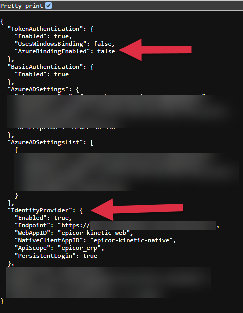

  • Browse https://YOUR-APPSERVER/EpicorInstance/api/.configuration and confirm:
    • "IdentityProvider": { "Enabled": true, "Endpoint": "…", "ApiScope": "epicor_erp", … }
    • "TokenAuthentication": { "AzureBindingEnabled": false }. If this is still true, IdP won’t show.

It does in 2025.2 at last that’s what I observed in the exchange. It specifically requests response_type=id_token token
And I don’t have an option to tell it otherwise. I can only go off the observed exchange though so maybe if the client supports AuthorizationCode + PKCE it would use it but this specific request initiated by the Kinetic Web App calls for id_token token :man_shrugging:
@Olga do you know?
homepage still uses it AFAIK :woman_shrugging: I remember I switched IDP portal itself to PKCE last time I worked there, several years ago.
When you create an app in the IDP portal, there is legacy JS template - for implicit, and another one for PKCE.
Unfortunately Kinetic UX implementation was done before the PKCE became a standard and they did not rework it since then.
