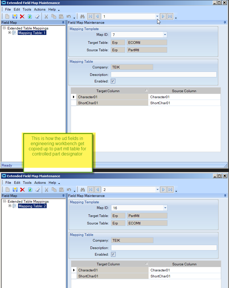

The PORel.ReqNum holds the requisition number in it. Can you do a data directive using this field to watch for change from nothing to req number and then fill out the req UD fields with the data? I think one other possibility would be to extended field mapping. I had an example years back where we did this below and I haven’t touched it since, but it works without complaint:
