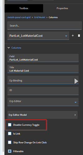

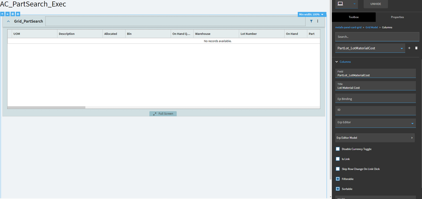

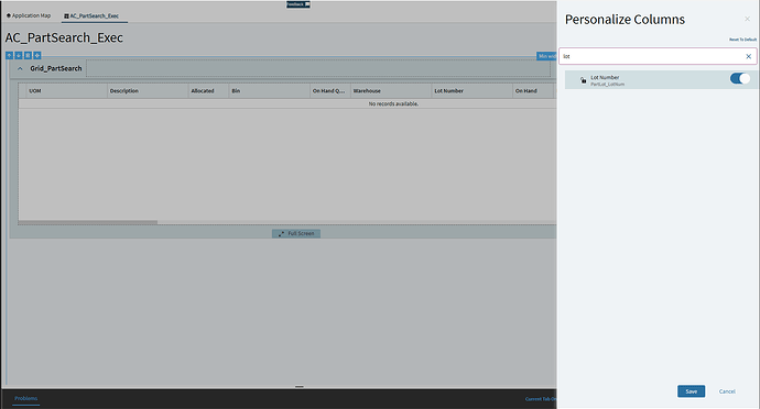

I have a dashboard I am trying to make through app studio; I am creating the app using a BAQ that has some part information. Included I have the PartLot_LotMaterialCost field that should be on the BAQ. Every other field is working just fine, but this one despite being on the column list is not showing up on the grid? I recreated the BAQ and app a few times manually and using the wizard, neither seem to be working. Anyone know why maybe?

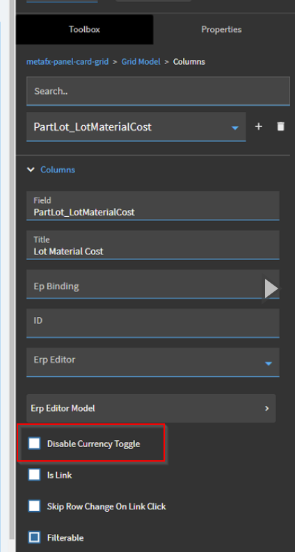

Disable currency toggle - check the box.
where is this checkbox? I dont see a currency checkbox
Wow I am blind haha, thank you!
I couldn’t find it either when Alisa told me. I was looking for “Currency Toggle” and was going to disable it!
