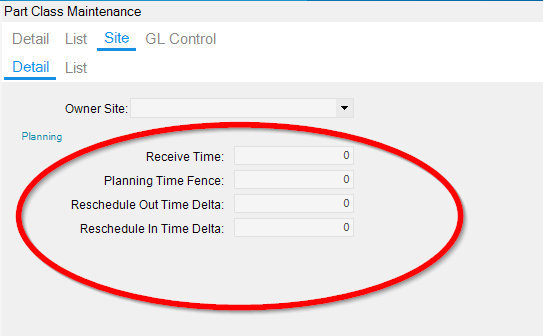

consider playing with the reschedule in/out deltas to eliminate the extra reschedule messages… example, if you set the reschedule out delta to 21 days, the system will ignore any reschedule out message unless they are over 3 weeks different. Same for Reschedule in delta.
The other option is to change the planning timefence, which will stop any suggestions within the timefence window (time fence is calculated as days from today). if you set the timefence for 14 days, then anything between now and 2 weeks from now will be ignored. personally i do NOT like the timefence, because the system will also never tell you to expedite within that window.
I hear you, Tim, but these changes are a lot more extreme than the deltas would explain. We have added delta-in and delta-out in order to reduce the overall glut of suggestions, but we proceeded with caution as that can hide activity that needs to occur. I think we are in a better spot on those items now.
