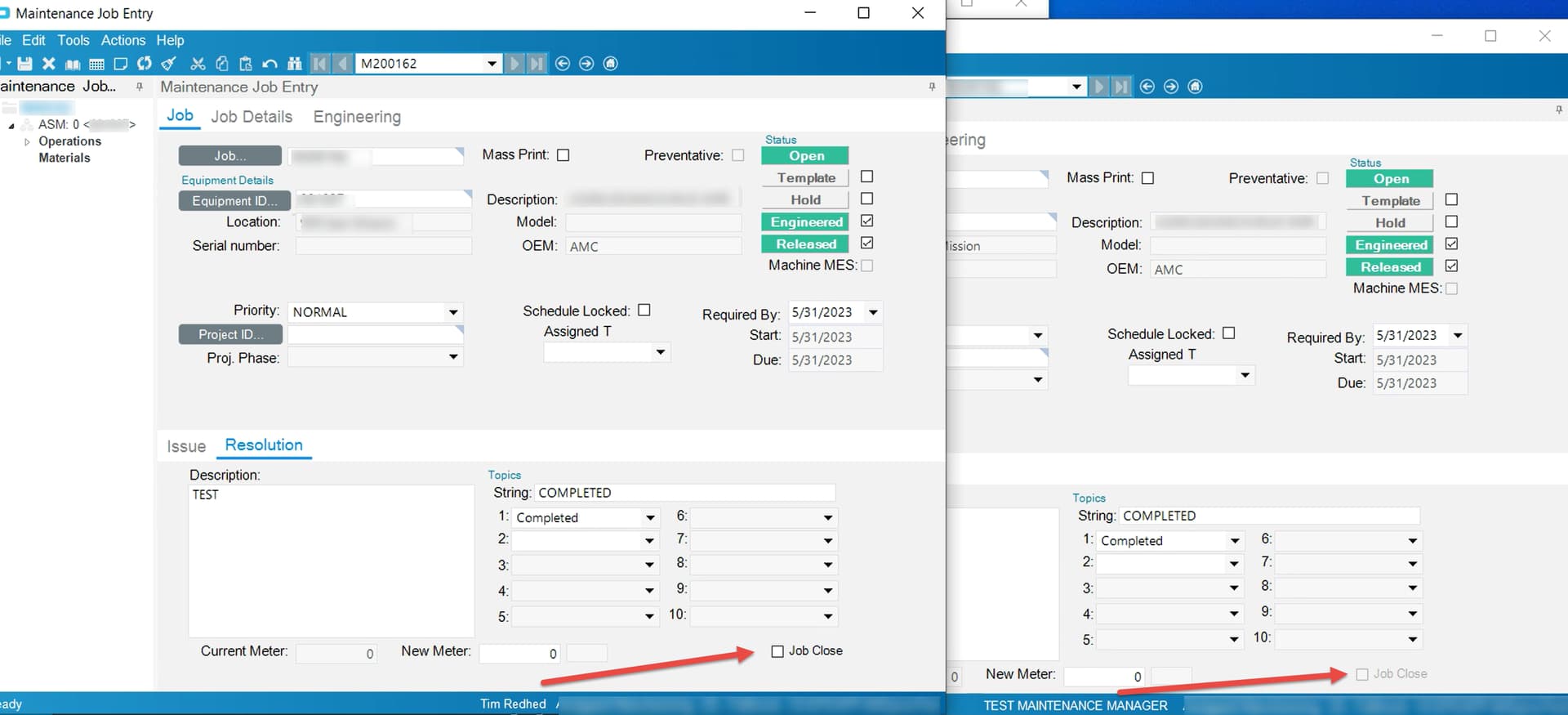

when I login as security manager, this checkbox is enabled normally after picking a Resolution topic. Login as a regular user, with limited menu access, it’s greyed out, why? The only thing I could think of was enabling menu access to Job Closing, but same result. No BPMs in place, it’s vanilla.

So that ‘assigned to’ field in my screenshot is custom field we added, no effect whatsoever, just allows us to view an employee we assigned to the job.

We’re not using it yet but this is the main screen:
Don’t see any People assigned anywhere else unless it’s an individual resource on an operation.

So we opened a support ticket with Epicor, and the fix was…you have to select “All Companies” in field security for that Job Close checkbox…even though we had no field security in play. Go figger.
