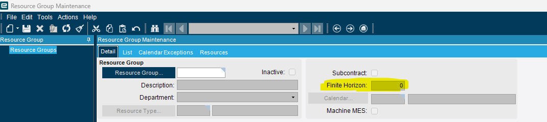

2 places that can interfere are on resource group, make sure the finite horizon is greater than zero.

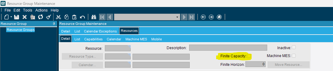

And make sure on the resource itself that finite capacity is checked:

The resources within the group do have finite checked, but the horizon is 0. I’ll tweak these and re run global.

I showed the horizon on the resource group but that is the default if it is not set specifically on the resource. On the resource it’s right under the finite capacity checkbox.

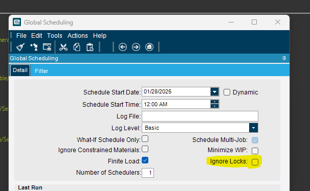

You may potentially have the jobs locked. You can override it on all jobs using the checkbox on global scheduling:

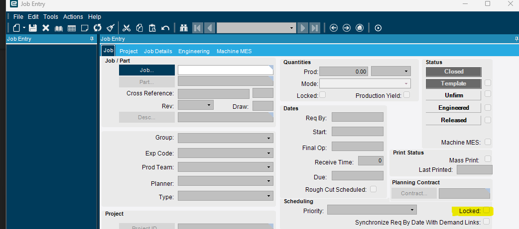

Alternatively, on each job you can check here:
